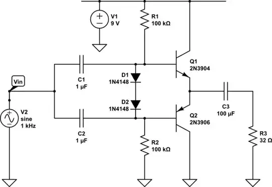

Looking at another question about an AB Amplifier stage the answer was the classic diode biased push-pull stage like this... which I voted up like others..
schematic
But then, while staring at, it I could not for the life of me figure out what those two diodes buy you over the base-emitter diodes that are there anyway.

Power.
The second circuit uses much more quiescent power because the ~40 uA of base current in each BJT produces ~4 mA of collector current, burning ~ 30 mW between the two BJTs.
In the first circuit, if the diodes are chosen as a good match for the BJTs, you keep the BJT's very near the edge of forward active region without actually getting them there (until they're needed) and much less quiescent power is used.
Another important point is that with the diode biasing, the circuit can be used DC coupled:
DC coupling is handy when this is used as buffer for an op-amp as it lets the buffer be in the feedback loop for all frequencies and keeps the op-amp output from running off to the rail.

    Thanks. Yes I had actually thought of that, and dismissed the 4mA as trivial, but I suppose for a battery operated widget it would be more relevant. I always had issue with the "the diodes are chosen as a good match for the BJTs" boilerplate statement... If, for whatever reason, the diodes are a bit high, you pretty much end up with the 2nd circuit anyway. – Trevor_G Sep 19 '17 at 19:21
    Another point: The diode scheme lets you DC-couple the input as shown in the 2nd schematic in the question you linked. – The Photon Sep 19 '17 at 19:27
  • @Trevor, true enough about getting the diodes matched. I actually used this circuit (DC coupled version) on a recent project and ended up burning significant DC power to keep things working smoothly...Luckily the power wasn't critical there. – The Photon Sep 19 '17 at 19:33
  • Yup. I instinctively avoid matching components... purchasing has a habit of changing vendors on discrete parts... The DC coupling thing really locks in the need for diodes or something else for sure. – Trevor_G Sep 19 '17 at 19:35
    One note on DC coupling: All the drive current for the upper transistor must come from the upper bias resistor (since you can't push source that current backwards through the diode). This necessitates much smaller resistor values to make sure that you have adequate current available to drive the base of the NPN. – Frosty Sep 19 '17 at 19:46
    @trevor truly good matching is only really accomplished when the parts are on the same die. If you really need to do it with discrete parts, people smarter than me have figured out loads of tricks that make it all work, but generally IC amplifiers will win out. – mbrig Sep 19 '17 at 22:28
