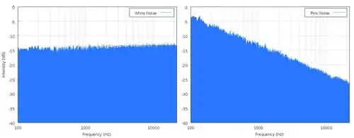

The left graph shows the flat spectrum of white noise, the right graph shows pink noise decaying 3dB/octave:

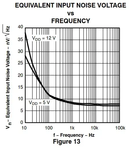

Note that the actual noise curve is not always 7 nV/√Hz, it slopes up at low frequencies:
TLC071 equivalent input noise voltage vs frequency
Turns out that's ok because the X axis is logarithmic and the units of noise are not, so it has very little effect on the total (the non-flat part below 1 kHz is only 5% of our total bandwidth, measured linearly). If you need a more accurate value you can (numerically) integrate and get the area under the (squared) curve: $$ v_\mathrm{RMS}=\sqrt{\int^{f_2}_{f_1} \! \tilde v(f)^2\,df} $$ Or simulate it in SPICE (I get 0.82 μVrms EIN).
