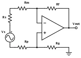

For example, how would you calculate the output noise of this circuit?
A differential op-amp circuit
Which noise sources do you include?

OK, I know how to do this now.
There are 3 main sources of noise that need to be calculated:
  • Thermal noise of the resistors themselves
  • Voltage noise of the op-amp itself
  • Current noise of the op-amp, which interacts with the resistors to produce a voltage noise
So first, you want to find the equivalent resistance seen from the inputs of the op-amp looking outward into the circuit, with voltage sources (such as the op-amp output) set to 0 V (equivalent to converting them to short-circuits to ground). For this circuit: $$ R_\mathrm{eq}=(R_\mathrm{m}+R_\mathrm{s}+R_\mathrm{p})\|(R_\mathrm{f}+R_\mathrm{g}) $$
Virtual ohmmeter looking out into the circuit from the op-amp inputs
So for example, if Rs = 100 Ω, Rm = Rp = 1 kΩ, and Rf = Rg = 100 kΩ, then Req = 2.1 kΩ.
To find the thermal noise of this equivalent resistance, use the Johnson–Nyquist formula: $$ v_\mathrm{n}={\sqrt {4k_{\text{B}}TR\Delta f}} $$ There are online calculators to do this for you:
For example, with Req = 2.1 kΩ, at 27 °C, with an audio bandwidth of 22 kHz, the resistors would contribute 0.87 μVRMS = −121 dBV input noise.
Then find the voltage and current noise of the op-amp in the datasheet. Typically:
  • If \$R_\mathrm{eq}\$ is small, you want a BJT-input op-amp, which has lower voltage noise (0.7-5 nV/√Hz), but higher current noise (500-4000 fA/√Hz).
  • If \$R_\mathrm{eq}\$ is large, you want an FET-input op-amp, which has lower current noise (1-10 fA/√Hz), but higher voltage noise (3-15 nV/√Hz).
To convert the spectral density \$\tilde v\$ (in nV/√Hz) to a voltage (in VRMS), you need to multiply it by the square root of the bandwidth: $$ v_\mathrm{RMS}=\tilde v \cdot \sqrt{\Delta f} $$ So for example, if the op-amp is a TLC071, with equivalent input noise voltage density of 7 nV/√Hz, the voltage noise of the op-amp contributes 7 nV/√Hz ⋅ √(22 kHz) = 1.04 μVRMS = −120 dBV.
The resistor noise and op-amp noise are similar levels, which means they'll combine to about 3 dB higher, or −117 dBV. To calculate their combination exactly, since they're uncorrelated, you need to use root sum squared: $$ v_\mathrm{total}=\sqrt{{v_\mathrm{R}}^2+{v_\mathrm{OP}}^2} $$ So √(0.872+1.042) = 1.36 μVRMS = −117 dBV, as estimated.
The current noise is probably irrelevant for an FET-input op-amp, so we can skip to calculating the output noise: Just multiply the input noise by the gain of the amplifier. However, you need to multiply by the "noise gain", not the signal gain. To find the noise gain of the amp, convert your existing sources into short circuits and put a test voltage source right in series with the non-inverting input of the amp:
Differential amplifier with noise source in series with non-inverting input for calculating noise gain
So the op-amp will do whatever it takes for the inverting input to equal the non-inverting input. There will be one current path: $$ I=\frac{V_\mathrm{out}}{R_\mathrm{f}+R_\mathrm{m}+R_\mathrm{s}+R_\mathrm{p}+R_\mathrm{g}} $$ and this is related to \$V_\mathrm{t}\$ by: $$ V_\mathrm{t}=I(R_\mathrm{m}+R_\mathrm{s}+R_\mathrm{p}) $$ combining and solving: $$ \frac {V_\mathrm{out}}{V_\mathrm{t}} = \frac {R_\mathrm{f}+R_\mathrm{m}+R_\mathrm{s}+R_\mathrm{p}+R_\mathrm{g}}{R_\mathrm{m}+R_\mathrm{s}+R_\mathrm{p}} $$ So in our case, this is a noise gain of 96.2× = +39.7 dB, and our input noise of −117 dBV becomes −77 dBV at the output. (A TINA simulation gives 137.5 μVRMS = −77 dBV, for comparison.)

  • I know this is an old thread, but I am now facing something similar myself. I am confused when you calculated the equivalent resistance in your answer. You say that (m+s+p) are in parallel with (f+g)... would you be kind enough to maybe explain how to see this, or perhaps add a basic equivalent diagram? Are both Rp and Rs shorted to ground, as well as the op amp output, to be able to see this? – teeeeee Oct 01 '19 at 11:00
  • @teeeeee "you want to find the equivalent resistance seen from the inputs of the op-amp looking outward into the circuit, with voltage sources converted to short-circuits (to ground)." – endolith Oct 01 '19 at 16:07
  • @teeeeee in other words, remove the op-amp, place a ground where its output used to be (since that's a controlled voltage source) and then connect a ohmmeter to where the input terminals used to be. Rf will be grounded like Rg is, so they are shorted together – endolith Oct 01 '19 at 16:08
    please forgive my struggle with this, but I'm still not seeing it. Do you mean place an Ohmmeter in series with each input, with their negative sides to ground? Or a single one that would be effectively inside the op amp across the pins? Isn't the goal here to calculate the effect the input current noise of the op amp will have? Also, do you remove the voltage source and short it to gnd as well? Maybe a sketch would really help me if you have time. Can you point me to a reference where this technique of adding the Ohmmeter and gnding the output is explained? Thanks for you pateience! – teeeeee Oct 10 '19 at 09:21
  • @teeeeee Yes, a single ohmmeter that replaces the op-amp inputs. Yes, this equivalent resistance determines the effect the input current noise of the op-amp has. Yes you remove all voltage sources and replace with shorts to ground (equivalent to making them 0 V voltage sources). I'll try to draw a picture – endolith Oct 10 '19 at 14:49
    @teeeeee Added an image to the answer – endolith Oct 10 '19 at 15:07
