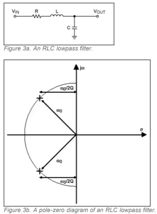

In all the texts I encountered so far, I find the following pole-zero diagram example for an RLC series circuit:
The transfer function for the above circuit can be found as:
H(s) = XC/(R + XL + XC) = (1/sC)/[R + sL + (1/sC)]
H(s) = 1/(LCs² + RCs + 1)
But when I plot the pole-zero diagram of the above circuit for different R,L and C values, I don't always obtain the poles as conjugate.

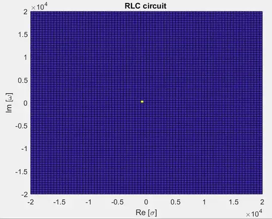

3-) Pole at the origin
R = 100;
C = 0.001;
L = 0.001;

Following the answer I was able to reveal the higher pole for the third case:

  • I think the last plot shows a pole very close to the origin but it is not. Should you zoom out, you should see the second real pole at a higher frequency but it does not appear in the plot. When $Q$ is low ($R=100;\Omega$), as explained in my answer, one pole dominates the low-frequency response and is located at $Q\omega_0$ while the second pole lies at $\frac{\omega_0}{Q}$. Your last plot shows the first one only. A pole at the origin would mean that $s=0$ is a root of the denominator $D(s)$ which is not your case. – Verbal Kint Jul 12 '17 at 07:41

For R = 100 and C - L = 0.001, zeta = 50 and Wn = 1,000 so the poles are at: -
\$s=1000(-50\pm\sqrt{2499}\$) = -99,990 and -0.01 so you are not able to see the higher pole on your graph but otherwise I would say I get about the same result.
