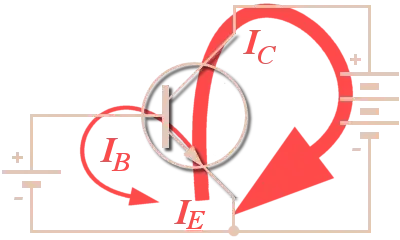

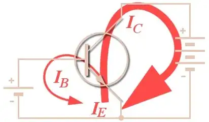

I am completely unable to understand the current direction in npn transistor. figure 1
in figure 1, the red arrow indicates the electron flow(which is from emitter terminal to collector terminal). thus according to the convention, the current flow is just opposite to the direction of electron flow. therefore the current must flow from collector terminal to emitter in npn trnasistor. enter image description here
but nothing like that happens. instead, the current flows from emitter terminal to collector terminal(that is in the same direction of electron flow). why is it so? why does this happen?

Thanks for pointing out where you got the diagram that you added to your question. (You probably should now include it inside your question, rather than leave it as a comment to another answer you got.) Here's the diagram you were asking about:
I think the diagram was trying to illustrate the conventional current flow on the left side and the electron flow on the right side. But they made a mistake and used a PNP schematic symbol on the left when they should have stayed with the NPN schematic symbol for both cases. If you replace the PNP on the left with an NPN symbol, then the diagram makes sense in the context of illustrating conventional current directions on the left side and electron current directions on the right.

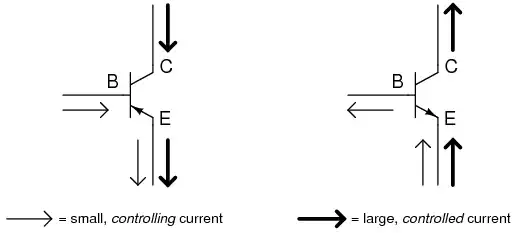

As far as "current direction" goes, and at least so far as copper wiring is concerned (which only has conduction band electrons to carry current, unlike aluminum which is a little more 'nuanced'), you simply decide whether or not you are talking about positive charges moving or negative charges moving. Benjamin Franklin, centuries back, didn't know how all this worked and had an even chance of "getting it right." Despite the 50% odds, he got it wrong and decided that it was positive charges. Ever since, partly because the earlier literature made the same assumptions, we've been stuck with it.
So. Don't get mentally mired in this. Since most of the rest of the world has accepted, and is using, the old Benjamin Franklin perspective of charge flow direction all you will do is continually confuse yourself and others every time to talk with someone else if you decide you are going to be the isolated voice challenging the convention everyone else is now using. Sure, the reality may be different. But so long as you stay consistent, it doesn't matter.
So current does flow from collector to emitter in the NPN. If you accept the convention, which uses "anti-electrons" as the charge carrier. If you refuse to accept it and go your own way insisting on using electrons as your charge carrier, then sure, it goes from emitter to collector. If it helps, turn this around and look at the PNP. Here, using the usual benjamin Franklin convention, current flows from the emitter to the collector and using your electron convention it flows from the collector to the emitter. Just the opposite.
Maybe for now it's better to just accept a different idea. That in a BJT operating in the active or saturated regions the emitter current is the sum of the collector and base currents, regardless of the direction you yourself insist upon. The direction you use for your imagination doesn't matter that much, so long as you stay consistent with your approach. The problem comes only when you want to communicate with others. Then you should use whatever they are using to understand and communicate back to you. Otherwise, the conversation devolves into debating terms and nothing gets done in the end.

The direction of the arrow in the transistor symbol (between base and emitter) tells you the direction of current:
PNP and NPN transistor
Note that "electron current" is the opposite direction from "conventional current"
Perhaps the site you used (can you share a link?) was talking about the directions in which the electrons flow?

  • https://www.allaboutcircuits.com/textbook/semiconductors/chpt-4/bipolar-junction-transistors-bjt/ this is the link of the site which i was referring to. the site was not talking about the electron flow but the current flow. – Saad Anwar May 19 '17 at 22:19
  • exactly that's my question why is the conventional current opposite to the electron current? what's the reason behind it? – Saad Anwar May 19 '17 at 22:22
