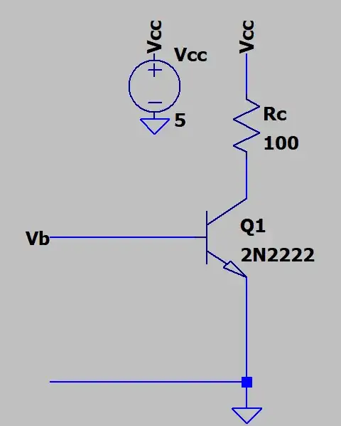

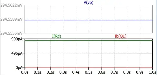

Simulation results also shows some amount of leakage current flows through the collector and the emitter while the base current is zero. And simulation also shows that the Vbe is forward biased when the base terminal is open as follows:
1-) Even though no voltage is applied to the base terminal, the Vbe junction is automatically forward biased and causes some leakage current. How is that happening? Does that come from KVL around the transistor?

Regarding your displayed values (curves, if you consider a straight line a curve), the simulation models incorporate far more equation elements than I'm willing to display here (because it would take me forever to explain them -- there are entire books on the subject of how simulation handles BJTs.)
But you can very easily make a mental prediction that explains your results. Take the current as \$1\:\text{nA}\$ (not worth trying to narrow it down more than that.) Typical values for \$I_{SAT}\$ for a small signal BJT are in the range of something like \$10-80\:\text{fA}\$. And the emission coefficient is almost always close to 1. So it's very simple:
$$V_{BE}\approx 26\:\text{mV}\cdot\operatorname{ln}\left(\frac{I_C}{I_{SAT}}\right)$$
From this, I get about \$V_{BE}= 26\:\text{mV}\cdot\operatorname{ln}\left(\frac{1\:\text{nA}}{20\:\text{fA}}\right)\approx 280\:\text{mV}\$. No shock there. Pretty close to what your curve shows. It has to be. It's just software doing its thing.

pA level measurements are never easy, even in a circuit simulator. LT spice by default has a minimum conductance of 1e-12 mho between nets. That's equivalent to a 1 GOhm resistor.
With GMIN=1e-12, You have a 5 pA of leakage from Vs to the base of Q1. The collector current is then, $$I_C = \beta I_B = (5pA)(200) = 1nA $$
Change GMIN to something more aggressive like 1e-15 and you will see a much different picture.
In reality, your device will have a \$I_{CB}\$ leakage current specified in the datasheet.
sstobbe
  • 2,992
  • Icb? That is about Ice in the question. – user16307 Jan 27 '18 at 21:59
    The reason I highlight Icb is that with the base OPEN, that leakage current sees a current gain of beta. – sstobbe Jan 27 '18 at 22:04
  • If you add a high-value resistor like 10 MOhms from base to ground, you will shunt Icb leakage current to ground versus into the base of q1. – sstobbe Jan 27 '18 at 22:08

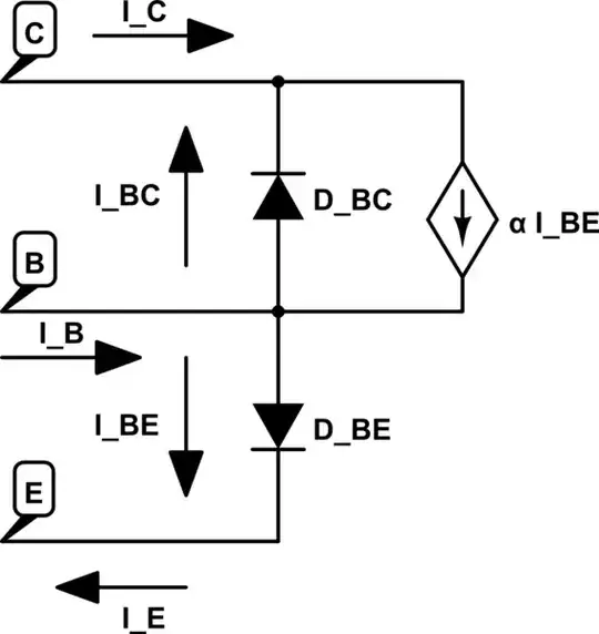

Simplified Ebers-Moll model:
schematic
Since base is open, \$I_B = 0\$, so
$$\alpha I_{BE} - I_{BC} - I_{BE} = 0$$ or
$$(1-\alpha) I_{BE} + I_{BC} = 0$$ or
$$I_{BE} = -\beta I_{BC}$$
Since \$V_{CE} >> 0\$, \$I_{BC} \approx -I_{S}\$ so
$$I_{BE} = \beta I_S$$ and
for typical \$\beta = 100, I_S = 10^{-12} A\$
$$I_{E} = 100I_{S} = 10^{-10}A$$
