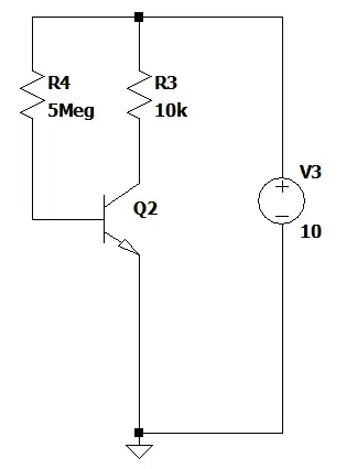

In the circuit below, the texts mention the problem with this kind of biasing here is if the hfe(β) varies then the Ic will vary in linear reagion. (What varies what here also not clear, I thought all variation source was Vbe). Anyways:
Their argument is the following:
Imagine for this circuit we want to size R4 for a desired Ic, known R3, known supply voltage Vcc and known β.
So we can say the required Ib is:
Ib = Ic/β
and we can write a KVL equation to find R4:
Vcc-Vbe = Ib x R4
R4 = (Vcc -Vbe) / Ib
Then they say this circuit is biased well but if the β varies i.e if you rely on datasheet, or change the transistor ect, the circuit will fail.
I can understand that, but my problem is when they reach sizing R4 in their calculation they take Vbe as a fixed value like 0.7V. But indeed Vbe changes with R4 and we also know that a small change in Vbe has a huge impact on Ic.
I don't know why they don't mention this as a problem. I'm wondering if I misunderstand something here. So my question is, imagine if the β were guaranteed to be fixed as a constant and we don't have a problem with β variation. Don't we still have a problem here not knowing Vbe's exact value when sizing R4 from that KVL equation? I mean Vbe varies with R4 but they still take it as 0.7V.
(Shouldn't they find the real Vbe form Eber Molls equation to find the accurate R4? But for that we need reverse sat current.)

  • You are correct. VBE also varies due to temperature and process. – Mike Apr 02 '18 at 19:43
  • I checked maybe five texts they all take Vbe as 0.7V. There must be something here not making the accuracy of Vbe so important but I couldn't get what. – cm64 Apr 02 '18 at 19:45
  • They first say Vbe is very sensitive thing because a tiny variation will drastically change Ic, but right after they take Vbe as 0.7V which doesn't make so much sense to me. – cm64 Apr 02 '18 at 19:47
  • Vbe is around 0.6 at 100uA (memory)? 0.65V in mid range 0.7 V nominatal rated and pulsed high current >1 depending on power rating etc. Since that method if hFE dependent with V+-Vbe / Rb =Ib using emitter follower H bias is more stable as well as negative feedback ratios – Tony Stewart EE75 Apr 02 '18 at 19:54
    Maybe they think Vcc is at least 10 times bigger than Vbe so taking Vbe between 0.6 and 0.7 would not change Ib much in the equation Ib=(Vcc-Vbe)/R4. – cm64 Apr 02 '18 at 20:03
  • The sat current, beta, VBE, thermal voltage, and more vary with temperature. What actually qualifies for a metal, in fact, varies with temperature. Ebers-Moll, inside a BJT -- see bottom, biasing. – jonk Apr 02 '18 at 20:06
  • If you want a clue about how you might actually *derive* the VBE from KVL, you might look over this: LambertW function and also another example using LambertW. – jonk Apr 02 '18 at 20:09
Vbe is around 0.6-0.7V. The supply is 10V, so a 0.1V variation in Vbe changes the base current by around 1%. The variation of the resistor + supply voltage (especially the latter) are probably significantly less accurate than that.
On the other hand, take a typical transistor such as 2N4401, hFE at 1mA could be anywhere between 40 and 500, more than a 10:1 range at 25 degrees C.
If if you pick an binned gain transistor and match a resistor (or trim it with a pot or even more tightly selected resistors), it will vary more than 3:1 over the -40 to 125 degree C temperature range (on top of the variation at 25 degrees C) so the circuit will not be very stable under varying conditions.
1000% and 300% are much greater than 1%.
It's a bad method but it's not totally impractical for narrow temperature ranges with binned (more tightly specified) gain transistors and where you don't care too much about output bias level.
