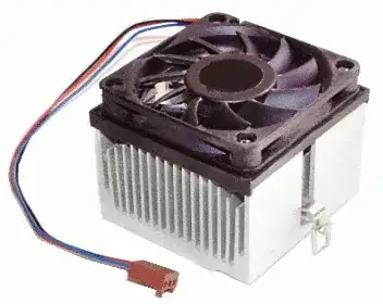

The geometry of the heat-sink chosen also greatly affects the performance of the fan. A rotary fan slapped on top of your typical linear finned heat-sink will actually be quite inefficient. In fact the region directly under the centre of the fan will get virtually no air movement at all. This of course is unfortunate, since that is normally where the thing you are trying to cool is located.
Further, unless the fins are quite deep the airflow is badly distributed in general. Too shallow, and the resultant back-pressure can actually "stall" the fan. In those circumstances, installing the fan in the "suck" direction can actually improve the situation since the air will enter the sides of the heat-sink more linearly to fill the void in air pressure created by the fan.
Arguably, the heat-sink shown above might be more efficient with longer fins and the fan mounted at one end.

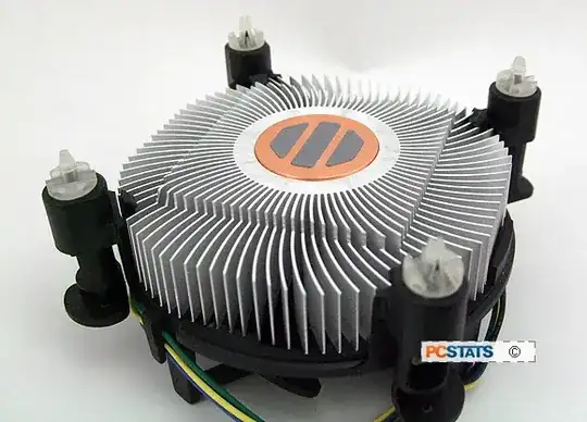

Better designs use radial heat-sinks like the one below. As you can see, the style here is radially symmetric to the airflow on the entire circumference of the fan and consequently delivers a more even heat transfer around the central core.
However, even with this style, the core itself is still badly ventilated. As such it is usually manufactured as a solid high thermal conductance core which acts as a heat-pipe. Even then, looking at the image below, the area around the core in the square section that touches the chip actually is an air void that is quite inefficient. A better design would have that area filled with metal in a rounded conical structure. However, that would of course be impossible to extrude.

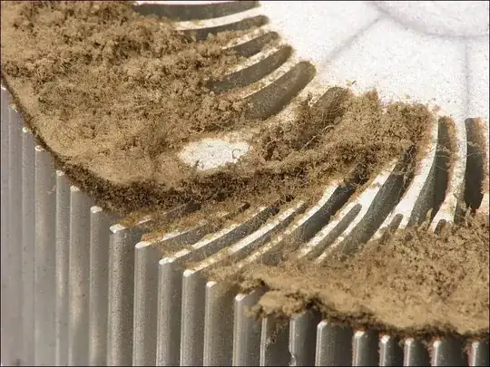

Another serious issue is contamination.
Dust and dirt is going to get into your fan and your heat-sink. Over time this builds up and severely degrades the performance of the unit. It is therefore prudent to design your fan and heat-sink arrangement to be as self flushing as you can.
This is where a blower fan usually wins out. With controlled airflow and if the air coming in can be kept clean, it tends to blow dust out of the heat-sink. Which brings me to the next point.

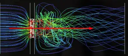

Now to the matter of turbulence.
The highest amount of heat transfer from the heatsink (or other hot components) occurs under laminar fluid flow. When the air flow increases, you may eventually reach a point where the airflow becomes turbulent. The effects of turbulence are:
  • the effective area of the fan decreases - ask any prop-plane pilot about the effect on propulsion when increasing prop speed beyond the RPM red line
  • noise increases = energy lost
  • vortices form, depositing air-borne debris in the lower velocity areas
  • the efficiency of the fan falls and its temperature may increase
  • cavitation occurs giving rise to areas of zero airflow, and hence
    rampant temperature rise.
So, turbulence is definitely NOT your friend.

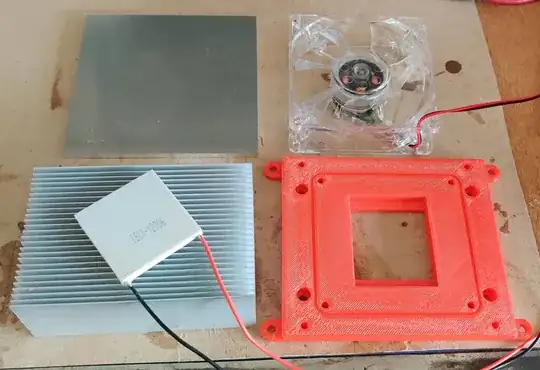

Background
I'm in the process of developing a cooler/equipment dehumidifier using a standard Peltier based thermoelectric cooling device (TEC1-12706), and was deliberating as to whether to use a cooling fan to suck or blow over the hot side heatsink. Whilst looking for an answer I came across this thread which I found very informative, but it didn't provide a compelling case either way. So, it made sense since I'd created a prototype to perform some measurements with the cooling fan operating with airflow in both directions.
Basic components excluding copper plate
TEC device and copper plate installed

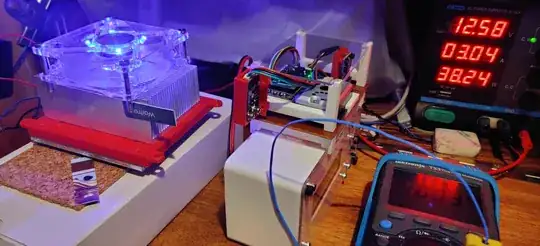

Experiment
Test Set-up
  • Power supply set to 12.58V
  • Unit situated with hot side heatsink to the top with fan loosely attached
  • Thermocouple attached to a multi-meter inserted down centre line of heatsink
  • IR temperature sensor facing end of heatsink (not really effective)
  • Thermal imaging camera
All thermal interfaces smeared with heatsink compound, noting comments in the thread about the need to be meticulous in its application.
Procedure
  1. Run for a period with fan blowing to allow readings of current and heatsink temperature to stabilise.
  2. Remove fan and monitor heatsink temperature
  3. Repeat 1 above with fan sucking air through the heatsink
  4. Repeat 1 and 3 to confirm results.
Test set-up
Results and Conclusion
The temperature of the heatsink stabilised at 34C and the current to the TEC and fan settled to 3.04A +/-10mA for both sucking and blowing, after about 10 minutes. The cold plate edge (100 x 100 x 4mm aluminium) eventually stabilised to around 8C after 30 minutes of operation according to the thermal imager with condensation starting to be a serious issue. Ambient temperature of the room 22C.
With the fan removed, the temperature climbed to 46C and the current dropped to 2.85A after less than 2 minutes at which point the fan was put back in place for fear of damaging the TEC.
In conclusion, from this simple experiment, I take it that it doesn't really matter whether the fan sucks or blows when operating with a heatsink of the variety used for the experiment (100 x 69 x 37mm, LWH with 26 fins), and a standard 80mm fan.
In future, I think I will operate the fan in suck mode, if only because the heat from fan motor is not is not adding to the problem.
