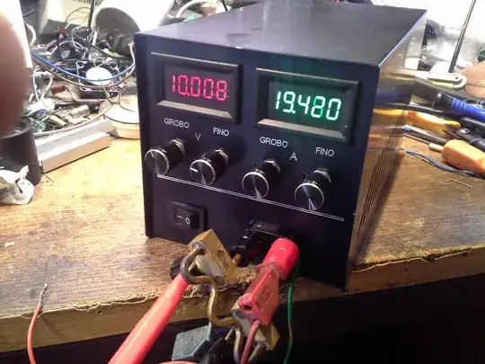

I do believe in a simple thing about cooling: it's better to cool the components instead of draining the heat. Why? Let me show you a simple reason, that was done on my lab. power supply on pictures below:

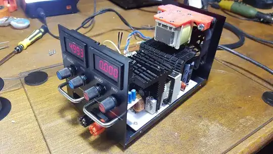

This is my lab bench supply with 80x80mm FAN mounted on back. It is blowing air from OUTSIDE to the INSIDE. Why? Look another photo below. It's not the best, but that's all I got on me right now.
If I would be sucking air from inside to the outside, the fan would suck the air from closest gaps to the fan. But instead of this, the air is being blown into the power supply across the components, which will cool them all and go through any hole in the power supply cover as it wants.
Jakey
  • 808
  • 17
  • The air should move along the fins, not across. The second heat sink doesn't get air flow from the fan. I suspect that thermal design was an afterthought in this instrument. Let the -1 serve as a warning beacon to others. No hard feelings. – Nick Alexeev Feb 18 '18 at 08:07
  • No hard feelings for sure, I'm open for any kind of debate. Well, I see what you mean but the thing is, that the air will cool the fins of the heatsings, eventhough it don't flow directly along the fins. In this case, it's okay as it is, but for large series, I'd design it differently. – Jakey Feb 18 '18 at 22:27
