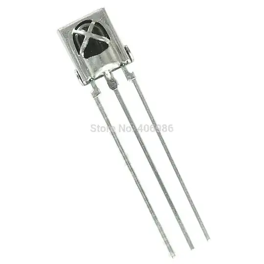

I'm guessing it's a Faraday cage around the receiver, but don't know why they might need one. Is there some sort of common interference around 38kHz (their operating frequency)?
It's the only component I think I've used that gets this special treatment. A larger cage may be around one in a VCR, and a little baby cage sometimes appears around the standalone PC mount component:
PC mount

    Because it holds the lens down? – Ignacio Vazquez-Abrams Mar 30 '17 at 07:41

  • The answer from @analogsystemsrf is interesting, but it could also not be a faraday cage at all, but rather a light filter to make the diode more omni-direction and less sensitive to swamping from head on signals. – Trevor_G Mar 30 '17 at 13:12
  • Ignacio no, it doesn't... – Passerby Mar 31 '17 at 03:19
  • @Trevor, while it could be blocking signals from stray directions, the telltale that that's unlikely is the figure X running across the face of the receiver; this wouldn't serve the purpose you're suggesting but would instead deflect light coming from exactly the direction of interest. – R Zach Mar 31 '17 at 05:00
  • @RZach. Yes I though that too. But then I remembered how TV and VCR 's have to receive signals from a wide range of directions, bounced off walls, etc. As such, upping the gain and reducing the "head-on" glare would be prudent. However, I am only theorizing. – Trevor_G Mar 31 '17 at 13:08

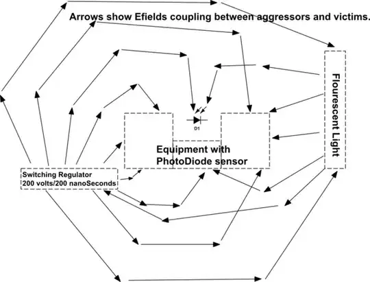

Line-of-sight does not matter. The Efields explore all possible paths, including up-and-back-down or around-corners.
schematic
HINT TO BEHAVIOR: the Efields explore all possible paths.

EDIT To model more common mechanical structures, to determine the ultimate trash levels as an Efield couples into a circuit, we need to know (1) the impedance of the circuit at the aggressor frequency, and (2) the coupling from a 3_D trash aggressor to a 3_D signal chain node. For simplicity, we'll model this in 2_D, using the available grid_of_resistors
schematic

  • Am guessing the center pin is gnd, which would extend inside to support the chip substrate. Would that not be shield-enough? Am also suspicious that the frame "X" blocks the head-on optical path...could it be an optical diffuser ? – glen_geek Mar 30 '17 at 16:43

The answer is quite simple.
When the PD is receiving a small signal at greatest distance, the PD may only be receiving <1uA and thus even with 60 dB gain with AGC IR Rx has >1MΩ impedance making it sensitive to stray E-fields picked up the the area of of the detector and wires.
Shielding it on the outside may compare well to Sharp/Vishay's shielding on the inside, but shielding is necessary due to the high impedance to extend the range of detection to perhaps 50m using the appropriate IR 5mm emitter by shunting stray E-fields.
One can tell it is IR due to the daylight blocking filter and 3 pins needed for the integrated BPF AGC and ASK detector.
