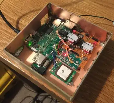

I have just finished assembling a Raspberry Pi-based project into a DIY box made from copper clad FR4 PCB, with the edges soldered together and the copper surface connected to ground.
I expected, when I put the lid on the box, the onboard Wi-Fi and the USB GPS receiver would stop functioning - that is, the Pi would drop off Wi-Fi and the GPS fix would be lost.
Instead, there is no discernible effect. Wi-Fi and GPS function as if the metal lid is not present.
Given the entire reason I put this project in a copper clad case was to shield it from RF (it will be operating in the near field of a 5W VHF FM transmitter), I could do with understanding what's going on here.
Here's a pic
lid off

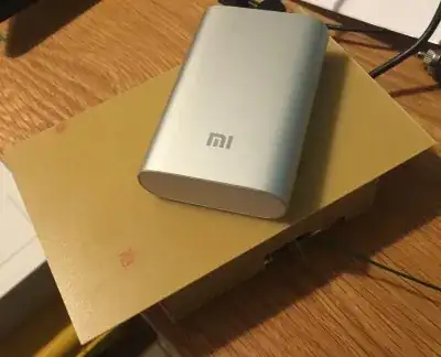

and with the temporary lid on...
lid on
(note the thin stripped wire is just to ensure the lid is making electrical contact, and the USB power bank on top is just providing some downwards pressure also to ensure contact)

  • Please post a picture of the box. Are you sure the top of the box makes electrical contact with the rest of the box? – user57037 Jul 03 '17 at 21:52
  • Done, and yes, definitely. – tomfanning Jul 03 '17 at 22:04
    I'm not sure, but maybe it matters if the lid makes good electrical contact along the entire edge of the box. If you just place the lid on there with the thin wire, it might only make good contact at that one wire... – marcelm Jul 03 '17 at 22:11
  • Fair comment. I'll experiment more on the bench. – tomfanning Jul 03 '17 at 22:16
    Yes, it is important that the lid make contact in multiple places. Basically, the gaps in a faraday cage should be small compared to a wavelength. 2.5 GHz is 12cm in free space. 5 GHz is 6 cm in free space. I would be shooting for good contact every 1cm or so. Also, there is a pretty large square hole. You may want to try covering that also, if it is operationally possible. Or reduce the aperture to the minimum, and provide contact between faraday cage and connector outer shell if the connector is needed in use. – user57037 Jul 03 '17 at 22:29
    Judging by what I've seen with regards to how high-end RF gear is shielded, I'm betting that if you had a continuous solder joint along all edges including the lid forming a totally sealed box, then the PI should drop off the face of the earth. You've got a large cut-out around the... HDMI? connector, that'll leak some RF too possibly along with the power cable unless you use feed-through capacitors and some ferrite beads/chokes. WIFI needs less that a trillionth of a watt worth of signal strength to run while GPS can get by on a million times less than the WIFI. RF shielding is hard ;) – Sam Jul 03 '17 at 22:31

For the box to be an effective Faraday shield, the entire peripheral of the top lid must be in electrical contact with the rest of the box. Failing this, RF can easily couple from the largely isolated plane of the lid to the internal electronics.
Also don't overlook the large opening you have on the side of the enclosure. I doubt it would allow the GPS to work but it could enable the ingress/egress of a 2.4 GHz signal.
