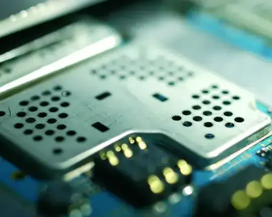

I am not talking about cutouts for tall components. I don't think they are for ventilation as they are often covered with manufacturer labels.

    Just my 5 cents, but the ones with only the cross-shaped metal are very similar to the solder part of the two-part shield I bought once for a project. You solder the holed part and then snap the solid part on it (if you look at the bottom row, the first and second are the same size, the third and fourth too, so I think they have to go together: you solder the first then snap the second onto it) – frarugi87 Sep 21 '17 at 12:21

Advantages of holes in shield:
  1. Allows some air flow for better heat dissipation. This is the primary reason.
  2. Less weight.
Small holes don't really compromise the shield, as long as the holes are significantly smaller than the wavelength of what you want the shield to attenuate.
As a aside, you won't ever see long slots in RF shields. If a larger overall opening is desired, it will be accomplished with a array of holes. The shield is then still a mesh in that area, which is mostly as good as solid, as long as the individual holes are small compared to the wavelength.
A single long and thin slot is actually a antenna. Imagine a conducting sheet with RF current flowing in one dimension. A slot perpendicular to the current flow has the same characteristics as a dipole antenna. In fact, such things are called slot antennas. Obviously it would be bad to add slot antennas to something intended to be a shield.

Good answers here already but I would also add, holes also significantly change the thermal/mechanical properties of the shield.
As you know, when metal gets hot it expands, similarly, it shrinks as it cools.
If a "can" type EMI shield is soldered down to the PCB, and said shield is solid, that will introduce a significant difference in expansion rates between the PCB and the shield.
This can cause effects like:
  1. Failure of the solder joints holding down the shield,
  2. Tearing the solder down pads off the board,
  3. Warping of the board, with possible resultant intermittent/failing connections elsewhere,
  4. Audible popping of the shield as internal stresses are redistributed. (This can also introduce a concussion shock to the joints and PCB.)
  5. The shield to dislodge.
This can be a significant issue if the EMI shield is soldered down during normal manufacturing where the boards are pre-heated before the solder flow phase. When the board cools again, a residual stress will be introduced. Boards can actually come out with quite the curve or warp in them.

Providing holes will provide shielding while saving on material costs.
Presence of holes doesn't mean that RF signals will pass un-attenuated. There is a cut off frequency for the given perforation dimension. In terms of wavelength, it becomes:
Cut off wavelength = 3.142 * radius of hole (for circular perforations)
For a 2.4 GHz wave, wavelength = 12.5 cm
Thus a hole smaller than 12.5/3.142 cm = 3.98 cm in dia will attenuate the RF signals.
In a lot of cases, shielding is required against 50/60 Hz line noise or some hundreds of kHz noise coming from a switching regulator. In this case, even a much bigger hole can provide shielding while effectively saving on material costs and making the system light-weight.

They may be for cleaning.
I have designed a few small RF shields like this. We always use small round holes similar to those shown in some of the pictures above. The shields are soldered in place during the normal reflow process at the same time as all of the other components on the board. After reflow the boards are cleaned using high pressure water jets (or sometimes solvents) to remove flux residue and other contaminants. Without holes in the lid, areas underneath the shield would not get properly washed.

An un-holey shield will obviously provide even better shielding and avoid problems with something shielded being nearer to the shield than the hole diameter (which is said to impair the shielding effect) - but will make any forced air or convection cooling ineffective (excepting whatever heat is transferred to the shielding material by convection within the shielding enclosure).
Also, larger holes allow positioning adjustment facilities (trimmer caps and pots) beneath a hole so they are accessible without removing part of the shielding - which is important since some circuitry will be inherently out of tune with the shield gone and/or hard to adjust because it will catch massive interference.

Also when the board goes through wave solder, the components in the can need to absorb heat, and if there is a solid can on top with no openings, the heat is reflected, which will change the mfg. recommended solder profile. Same is true (but even worse) for vapor phase reflow.
