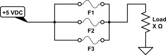

When I went to school we had some basic circuit design and stuff like that. I learned that this was a bad idea:
schematic

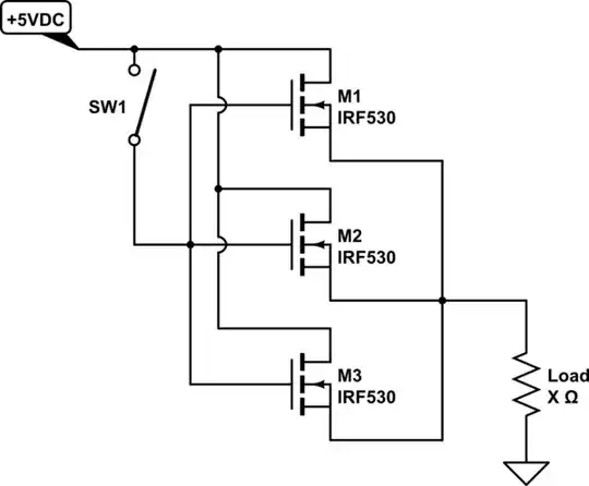

Since the current will almost certainly not flow equally over these three fuses. But I have seen multiple circuits that uses parallel transistors and MOSFETs, like this:
schematic
simulate this circuit
How does the current flow through these? Is it guaranteed to flow equally? If I have three MOSFETs that each can handle 1 A of current, will I be able to draw 3 A of current without frying one of the MOSFETs?

  • In the circuits you saw, were the transistors on the same die? The matching will be better in that case (still not perfect). – Justin Dec 12 '16 at 15:58
    You basically have 3 NMOS in parallel. Assuming they're all 100% equal and at the same temperature, then yes the current will divide so each takes 1/3 of the total. But operated like this, the NMOSes will not work as switches but as source followers and will drop about 2 to 3 V. – Bimpelrekkie Dec 12 '16 at 16:01
    FYI - Connecting fuses in parallel is dangerous. Wiring should be protected with one fuse. – vofa Dec 12 '16 at 16:02
    I realize you ask this regarding the current distribution between them, but if you ever paralell MOSFETs like this, you must use individual gate resistors or you will have destructive oscillations. – winny Dec 12 '16 at 20:24
  • @winny: As I commented in Jack B's answer, this is just a very simplified example circuit to illustrate what I was asking about. This is not a real life circuit. – BufferOverflow Dec 12 '16 at 20:59
    @vofa The question asker knows that. It says so in the second sentence. – user253751 Dec 12 '16 at 21:02

MOSFETs are a bit unusual, in that if you connect several of them in parallel, they share the load quite well. Essentially, when you turn on the transistor, each one will have a slightly different on-resistance and a slightly different current. The ones carrying more current will heat up more, and increase their on-resistance. That then redistributes the current a bit. Provided the switching is slow enough for that heating to happen, it gives a natural load-balancing effect.
Now, the natural load-balancing isn't perfect. You'll still end up with some imbalance. How much will depend on how well matched the transistors are. Several transistors on one die will be better than separate transistors, and transistors of the same age, from the same batch, or which have been tested and matched up with a similar one will help. But as a very rough number, I'd expect you to be able to switch about 2.5A with three 1A MOSFETs. In a real circuit, it would be wise to look at the manufacturer's datasheets and application notes to see what they recommend.
Also, that circuit is not quite what you want. You'd be better off using the N-type MOSFETs for low-side switching. Or, if you want to stick with high-side switching, get some P-type MOSFETs. You will also need an appropriately placed resistor to make sure the gates are not floating when the switch is open.

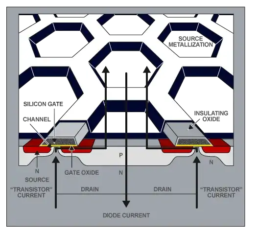

Note that MOSFETs rely on equal current distribution even on the single-device scale. Unlike theoretical models where the channel is represented as a line between source and drain, real devices tend to distribute the channel region over the die to increase maximum current:
(channel region is distributed under hexagonal pattern. the picture is taken from here)
Parts of the channel can be thought of as separate MOSFETs connected in parallel. Current distribution in parts of the channel is close to uniform thanks to the natural load-balancing effect @Jack B described.

  • Note that this image is actually of a bipolar power transistor, not a MOSFET. Compare with the photo closer to the top of the page, which is a HEXFET. The structural differences are subtle, but note that the gate bonding wire connects to a thin stripe of metallization around the perimeter of the die. – Dave Tweed Dec 13 '16 at 15:08
    @DaveTweed It seems I somehow associated the word complimentary with CMOS, and CMOS with MOSFET. Hopefully the new image is more on-topic. – Dmitry Grigoryev Dec 13 '16 at 16:57
