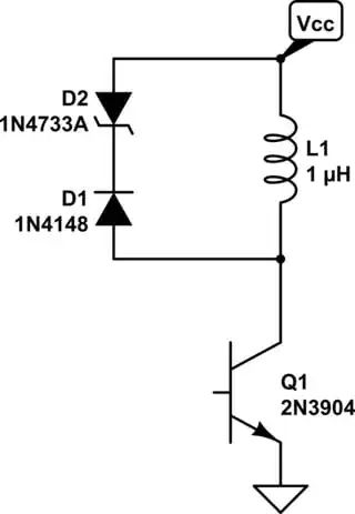

The zener diode would normally go in series with the freewheel diode, cathode to cathode (pointing at each other). This causes the voltage to collapse faster and therefore the coil field will collapse faster and therefore the relay/solenoid will open faster. In switch mode power supplies (SMPS) this is also known as a zener snubber.
schematic

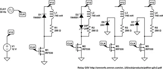

Some of these answers are confused about what happens with a simple diode. The energy is dissipated primarily in Rcoil, not in the diode.
Key is that when using a diode, the dissipation is an RL exponential decay (like RC). It is being exponential that makes it take so long (especially since release current might be only 20%). With a zener it is a linear drop to zero.
This simulates a real relay from its datasheet values of R and L.
schematic
You will notice that the ON (current rise) time is longer that the off time using a diode (L1,D1).
This is not correct as the inductance is greater (0.74H) when the relay armature is closed (better magnetic circuit) that when open (0.49H). The real On time (with 0.49H) and the off-time with a diode are almost the same.
L2,L4 currents are the same, as there is the same drop in both cases (and the same Vdrain on the fet.
ignore this
schematic
simulate this circuit
Henry Crun
  • 5,363
