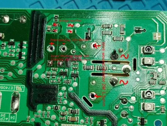

The board itself did not show any signs of visible damage (blown parts) but a few components were suspicious. A power resistor (2 W I would guess) was measuring 150 Ω instead of the 1.5 Ω that was indicated by its color code (rings). Another was a Zener diode that was measuring s large resistance (unmeasurable by my multimeter) in both directions.
I desoldered both of them from the board and my plan to fix it is to just strip one of the many USB charger boards that I have lying around and use its 5 V output as a new power source. That is my approach because it would take me longer to get the proper parts ordered and with shipping it would be much more expensive. Please correct me if this is bad approach.
My real problem is to identify the "real" +/- (ground) points for the board. From what I gathered, the board is using a 5.1 V Zener diode as a voltage regulator. Please find the image of the board attached. Broken parts are desoldered.
Can you help me understand what would the ground be in this circuit? Because of the bridge rectifier, the circuit is not showing continuity with some parts that need ground and that is confusing me a lot.

  • Zener 1SMA5913BT3 5.1 V by Onsemi
  • Electrolytic cap 25 V, 680 μF
  • Resistor 2 W, 150 Ω
  • Bridge rectifier (??) markings: 4 16G
Power supply area
Ground traced

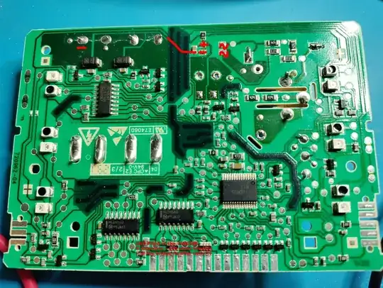

EDIT: Whole board image is attached.

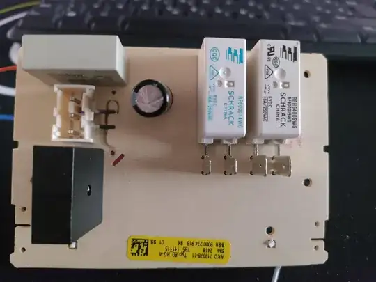

EDIT2: Front picture of the board added.
Front side

  • What's on the other side of the board? There must be something connected to the -ve of the bridge rectifier. – jonathanjo Jan 10 '23 at 09:55
  • @jonathanjo It's a single sided board. These dark areas are "second layer". They are some strange substance that links the traces exactly as shown with the darker traces, but they add 100ohms of resistance (that's the amount that my multimeter measured). – Stazh Jan 10 '23 at 10:05
  • This is the whole board. Only direct connection to - of the bridge rectifier that I've found is the one I've drawn. There are many points that show ~80ohm or ~170ohm resistance towards - of the bridge rectifier. Whole board – Stazh Jan 10 '23 at 10:19
    A 1.5 Ω resistor seem rather low in that position. Maybe you read the value wrong. 150Ω makes more sense. There is probably a big polyester through-hole dropping capacitor near the top- check that isn't shorted. Looks like you're working with a circuit that is 'hot' (connected to the mains directly). I suggest you toss the thing and buy a new one before you hurt yourself. Chances are it's a bad heater element and thus unlikely economical to repair (assuming it's a counter top thing). – Spehro Pefhany Jan 10 '23 at 10:24
  • @SpehroPefhany Yeah, resistor measures 150ohm. But its marking read 1.5ohm (used resistor marking decoder). There is additional capacitor on top layer: 0.68uF 275VAC X2 class Link It reads ~0.9M ohm. This is board is for the oven... Replacement board is 150€ and new owen 500€ + ... I would really like to fix it if possible. – Stazh Jan 10 '23 at 10:36

  • @jsotola thanks for the answer! I dindt even consider that. But the board does not have connection to the earth ground provided. It's all plastic that it touches so thats why probably. Will take a pic of the back and post. – Stazh Jan 10 '23 at 21:44
