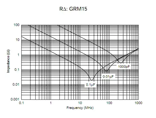

This plot from Murata shows the (magnitude of the) impedance vs. frequency for three different capacitor values in the same package (0402):
This shows that after a high value part (like 0.1 uF) passes resonance, a lower-value part (like 0.01 uF) just barely achieve a lower impedance before it too hits resonance and its behavior becomes dominated by its inductive parasitic, which is basically the same as in the high-value part.

  • Is the image for radial caps with leads? – tyblu Jan 19 '12 at 07:32
  • Now that I looked it up, I can tell you GRM15 is Murata's series name for 0402 parts. – The Photon Jan 19 '12 at 16:40
