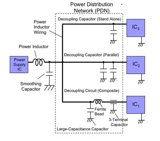

With rise time,t (ns) related to BW (GHz) f=0.35/t for 10 ~ 90 %
Choose caps with SRF > BW Use Ferrite beads for improved low noise for ADC and DAC’s.
The bottom choice is best. enter image description here
Low ESL have a shorter L/W ratio. Beware of anti-resonant combinations with ESL of large e-caps or high ESR , use ceramics . Decouple each LSI chip.
