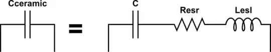

Real ceramic capacitor can be modeled by an ideal capacitor (C) connected in series with internal resistance (Resr) and inductance (Lesl). There is also R-isolation in parallel with C, but unless you go over capacitor's rated voltage it is unimportant for power decoupling applications.
schematic
Thus chip ceramic capacitors will act as capacitors only up to a certain frequency (self resonant for the serial LC contour which real capacitor is in fact), above which they start to act as inductors. This frequency Fres is equal to sqrt(1/LC) and is determined by both the ceramics composition and capacitor geometry - generally smaller packages have higher Fres Also, capacitors have a purely resistive component (Resr) which results mostly from the losses in the ceramic and determines the minimum impedance the capacitor can provide. It is usually in the mili-Ohms range.
