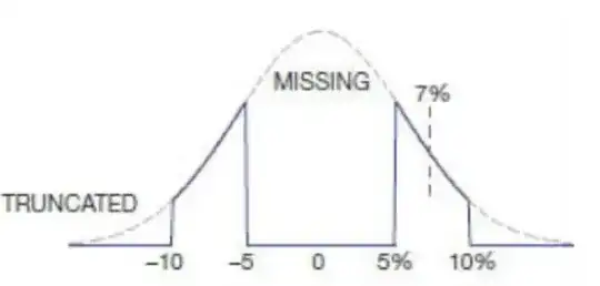

The manufacturer's selection process may also make the error non-random. For example, if they make resistors with a wide variance, then pick the ones that fall within 1% and sell them as 1% parts, then sell the remaining ones as 5% parts, the 5% parts will have a double-hump distribution with no values being within 1%.
Because you can't know the error distribution within the worst case error window, and because even if you did, the worst case stays the same, doing what you are suggesting is not useful to electronic design. If you specify 5% resistors, then the design must work correctly with any resistance within the ±5% range. If not, then you need to specify the resistance requirement more tightly.

    @Olin I'd even go a bit further about how the manufacturers "sort" the parts - they make a random batch of Rs, then they select as many "precision" valued (e.g. 1%) Rs as they need for the market expectation, and throw the rest to lower prec. ranges. The same goes with V tolerances for 1N400X diodes - I recall testing some DO-41 1N4001's just to realize they flawlessly worked for 230V AC... I asked a vendor about it, and he told me that they have just a single production line - they take as many 1N4003s as they need to from high-spec parts, and sell all other as 1N4001 - YMMV, obviously. –  Apr 14 '16 at 16:14
  • @vaxquis Do you have any references regarding how manufacturers sort resistors (or define "tolerance")? When this was asked a few years ago, I looked at various manufacturers web-sites and datasheets and could find nothing. I emailed Vishay with several related questions, but got no response. – Tut Apr 14 '16 at 17:18
    @Tut: I doubt manufacturers are going to tell you how they test and sort parts. All they are going to say is that 5% parts will be within 5% of the nominal value, and that's all you should care about anyway. Strategies for binning parts can change. If it's not in the datasheet, then don't count on it and don't try to guess or assume beyond it. – Olin Lathrop Apr 14 '16 at 17:28
  • @OlinLathrop I think you are probably right which explains why I was unable to get an answer (although I think they should at least tell you whether or not they test 100% of the parts). There seems to be a lot of speculation about this (or people claiming to know how they do it) and even debates on the definition of "tolerance" as used by the manufacturers. The reason I didn't answer a few years ago was that I preferred not to speculate. – Tut Apr 14 '16 at 17:39
    @Tut https://www.maximintegrated.com/en/app-notes/index.mvp/id/5663 We say "seems to" and "appears to" because sales volume and human nature also influence the mix. For example, the plant manager may need to ship 5% tolerance capacitors, but he does not have enough to meet the demand this month. He does, however, have an overabundance of 2% tolerance parts. So, this month he throws them into the 5% bin and makes the shipment. Clearly deliberate, human intervention can, and does, skew the statistics and method. –  Apr 14 '16 at 18:47

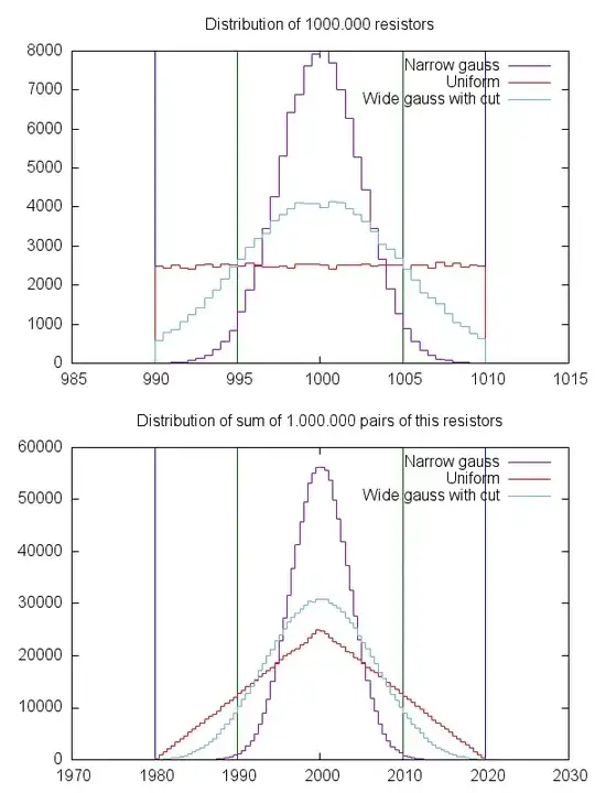

I did a simulation, for which I generated a set of 100,000 resistors with 1% tolerance (easier to handle than 5%). From this, I took 1,000,000 times a sample of two and calculated the sum of them.
For the set, I assumed three different distributions:
  1. A narrow, perfectly gaussian distribution with \$\sigma=2.5\$. This means: 63% of all resistors are in the range \$1000\pm2.5\Omega\$ and 99.999998% are in the range \$1000\pm10\Omega\$.
    Think of a manufacturer with a reliable production process here. If he wants 1kOhm resistors with 1%, his machine produces them.
  2. A uniform distribution where the probability to get any value in the 1% range is equal.
    Think of a manufacturer with a very unreliable production process. The machine produces resistors of any value of a wide range, and he has to pick out the 1%/1kOhm resistors.
  3. A wide gaussian distribution (\$\sigma=5\$), where every resistor outside the 1% range is thrown away and replaced by a "good" one. This is just a blend of the first two cases.
    This is a manufacturer with a better process. Most of the resistors meet the specs, but some have to be sorted out.
Here is the result:
  1. When adding two values of the same gaussian distribution, the sum also is a gaussian distribution with a width of \$\sigma_{new}=\sqrt{2}\sigma_{old}\$.
    The resistors have a tolerance of \$\pm 10\Omega\$, which converts to a new tolerance of \$\pm 14.1\omega\$ or \$14.1\Omega/2000\Omega=0.7\%\$.
    The simulated data shows this, too, as the distribution is slightly wider that 0.5% (vertical green lines)
  2. The uniform distribution becomes a triangular distribution. You still get resistor pairs of 1980 or 2020 Ohms (5%), but there are more combinations with lower difference from the nominal value.
  3. The result also is a blend of the results of the first two cases...
As said in the beginning, it depends on the distribution. In any case, the probability is higher to get a resistance with less difference from the nominal value, but there's still a probability to get a value which is 1% off.

The image of tolerance shows how resitors are sorted during the production process. They are distributes in bins containing specified tolerance, so for example in the bin containing +/-10% you won't find any resistor that has better tolerance than >+/-5%, because those parts are contined in the bin of +/-5%. But if you biuld a series chain a large number of resistors, the mean value will be close to specified $$R=nR$$.
