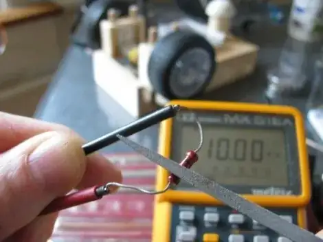

If you select a carbon resistor of too low resistance, you can tune it up by cutting it slightly with a file and then seal it with nail polish!
  • This seems to be the essence of Passerby's answer from over seven years ago, but Passerby provided more detail. Did you have something to add? – Elliot Alderson Jan 07 '21 at 21:29

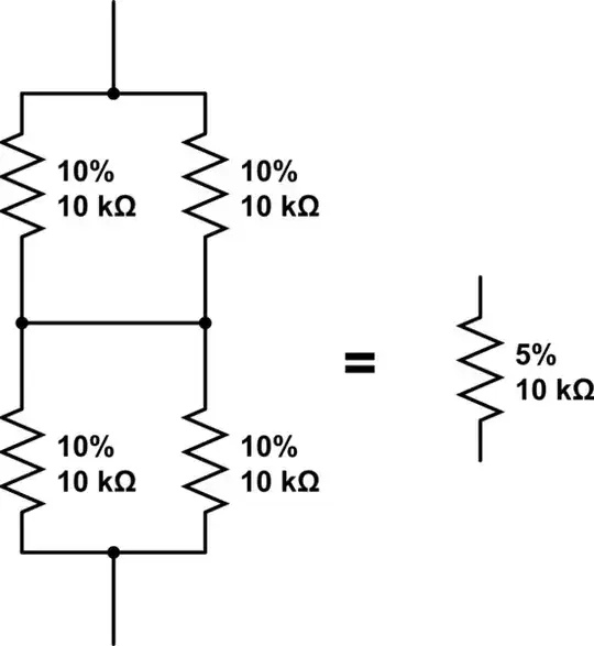

You're in luck, there is a method
Let us say you need 10k of resistance. Let us furthermore say you have a limitless supply of 10k resistors - and they're all 10% but you need 5%.
schematic
Be advised: The percentage numbers are NOT exact. I could calculate the actual values if I had my notes nearby.
The brief explanation is: The more components you use, the less uncertainty you have because the errors will tend to average out.

    While I agree that the errors would tend to average out, the tolerance is still 10%. Consider the value if all four resistors were 10% high. – Tut Jul 29 '13 at 14:35

  • However, from what i understand, the worst case error would still be 10%. So in a sensitive system this is not an option. If you need 5%, you have to use 5% components. – Rev Jul 29 '13 at 14:38
  • Exactly ! I agree with Tut here. If you consider the worst case, that is all resistors with (10k + 10% of 10k) then all resistors will take a value 11k. So in effect the resistance is again 11k which shows that there is no change in the tolerance of the resistor. – IamDp Jul 29 '13 at 14:38
  • @VasiliyZukanov And still, while unlikely, you could have four successive 1K resistors from a tape of 10% parts that all measure 1.1K Ohm. Yeah, the manufacturer could have sold them as 1.1K 1% parts, but where's the guarantee? The point is that medivh's answer is potentially more expensive than a low tolerance part, takes a lot of extra PCB space and still does not save you from measuring the parts with a multimeter to be sure you get into your desired resistance range. – us2012 Jul 29 '13 at 14:45
  • This answer is just plain wrong. No matter how many high-error resistors you average, the worst case error for the combined resistance will still be the same. – Olin Lathrop Jul 29 '13 at 14:50

  • I've read some materials on the Web and now I see that I'm wrong. Removed all my comments. Sorry guys. – Vasiliy Jul 29 '13 at 15:04
