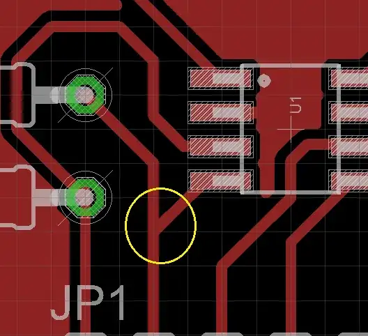

This image contains an example of an acid trap:
Acid trap example.
Image borrowed from this earlier question.
That image also ended up on an AutoCad site as an example of an acid trap.
That yellow circled junction can cause etchant to collect. That will cause too much copper to be removed - this can cause an open circuit if it etches through the trace.
The trap is formed by the acute (less than 90 degree) angle.
