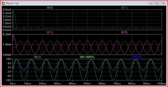

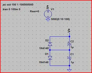

I thought I would set up a quick simulation based on the info given by Russell in his answer. The main point being the "act as if they had been bypassed by diodes" part. It's a very rough approximation but it gives a picture of what might be happening.
Bipolar Schematic
Bipolar Simulation
The I[D1] and I[D2] represent the reverse current through the caps. Initially one of the caps gets a brief surge of reverse current, then it becomes minimal for both. The I[C1] and I[C2] represent the current through the capacitance. This meet expectations of a 0.5uF cap at 100Hz. The capacitive reactance
$$\dfrac{1}{2\pi \cdot 100 \cdot 500e^{-9}} = 3183$$
So peak current will be
$$\frac{10}{3183} = 3.14mA$$
The light blue wave in the third graph is the supply voltage. The dark blue and green waves in the third graph represent the voltage seen across each capacitor (+ terminal with respect to - terminal of each)
As can be seen, both are correctly polarised.

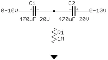

Yes, it is possible to combine two polarized caps into a effective single non-polarized cap, but with some restrictions. Each individual cap still needs to only see voltages within its specification. The easiest way to do this is to have a supply voltage that is guaranteed to always above or below any voltage applied to either side of the non-polarized cap. The two polarized caps are then connected back to back and a high value resistor connected to the supply:
Note that the total capacitance is the series combination of the two individual capacitors, which is half each if they are equal. In the example above, the total effective capacitance is 235 uF.
The voltage range of each cap must also be carefully considered. The worst case depends on what the external circuit can do. For example, suppose both ends are held at 10V, then the left end suddenly dropped to 0V. The center will be at -5V with 15V accross the right cap immediately after the step. The 1 MΩ impedance on the signal to the supply must also be considered. R1 must be low enough so that leakage thru the caps doesn't add too much voltage, but otherwise as high as possible to not load the signal.
In general, this sort of trick should be considered a last resort. Since bipolar capacitors are usually needed for signals, it can often be arranged to require a lower bipolar capacitance. Multi-layer ceramic caps have advanced significantly in the last decade. If you can make do with 10 uF instead of 100s of uF, a ceramic can can probably do the job.

    I'd do it with diodes (to prevent reverse-bias for each capacitor) rather than a bleed resistor, but yeah, you've covered it well. – Jason S Nov 07 '11 at 16:40
    ...but you haven't got the worst-case: suppose both ends are at 0V, and one end suddenly increases to 10V. Until R1 can equalize, this puts the middle node at 5V and reverse-biases one of the capacitors. Which is why I'd advise using diodes. It also keeps the effective capacitance at 470uF. – Jason S Nov 07 '11 at 16:44
  • @Jason: You're right about the reverse biasing. I guess that the outside voltage needs to be 1/2 the range past the end of the range, or -5V in the example instead of 0. – Olin Lathrop Nov 07 '11 at 17:30
    @Jason: Diodes are bad because they make the system non-linear and don't allow for a cap to be discharged easily. – Olin Lathrop Nov 07 '11 at 17:31
    @JasonS: You mean put a diode in parallel with each cap, right? Not a diode to ground. Supposedly, the capacitors in an NP act like diodes already. Why is this? – endolith Nov 07 '11 at 20:29
  • @OlinLathrop: Why would the caps need to be discharged? – endolith Nov 07 '11 at 20:30
  • @endolith: A fully charged cap has no room for a AC signal riding on that DC level. – Olin Lathrop Nov 07 '11 at 21:11
  • @OlinLathrop: Why would a capacitor be "fully charged" if it is being used for coupling AC signals? – endolith Nov 07 '11 at 21:56
  • @endolith: The diode make it eventually charge up one way. – Olin Lathrop Nov 07 '11 at 22:25
  • @endolith: yes, diode in parallel w/ each cap. "Supposedly, the capacitors in an NP act like diodes already. Why is this?" Unless the capacitor datasheet specs this, you can't rely on that behavior. As for why, something to do with electrochemistry / geometry – Jason S Nov 08 '11 at 00:34
  • "The film is permeable to free electrons but substantially impermeable to ions, provided the temperature of the cell is not high. When the metal underlying the film is at a negative potential, free electrons are available in this electrode and the current flows through the film of the cell. With the polarity reversed, the electrolyte is subjected to the negative potential, but as there are only ions and no free electrons in the electrolyte the current is blocked." http://ebooksgo.org/engineering-technology/ElectrolyticCapacitors.pdf – endolith Nov 17 '11 at 17:13
    @JasonS: In the absence of forward leakage, the total lifetime number of electrons which would ever be pushed backward through either capacitor would be limited to the number required to forward-charge the other. Whether the "diode" mechanism lets those diodes through quickly or slowly doesn't matter; most caps can tolerate a number of reverse-flowing electrons which is greater than the number of forward-flowing electrons that would be necessary to charge them once. – supercat Dec 24 '13 at 06:06

    Passing AC does not charge and discharge the capacitor repetitively. – endolith Aug 24 '14 at 00:17
  • How could it possibly not. The voltage changes from positive, to zero, to negative, etc., etc., and since V=Q/C, Q must change in amount and polarity, thus charging and discharging repetitively... Simple AC Electronics. – William Aug 28 '14 at 02:34
    Yes, the voltage changes from positive to negative, on both sides of the cap. Capacitors resist a change in voltage across their terminals; the higher the frequency, the more they behave like a short circuit. In an AC-coupling application, the voltage across the cap is constant (DC bias or 0 V); both sides move up and down with the signal together. – endolith Aug 28 '14 at 13:54
I saw the roll your own bipolar cap made from two back to back electros of the same value with the reverse diodes across them.This was back in 1988 ,when I was fresh out of Uni.I did not like them at the time and vowed not to do this on anything new .The broadcast audio product that used them was manufactured in hundreds and did not fail so my boss did not get me to redesign it .So the reliability was fine in this low ripple current application .What the tech and I did was test the aformentioned caps on the AUDIO PRECISION test set which was at the time the bees knees .None of us could find any distortion coming from the caps.This was not what I expected or what others that watched the tests expected.On the other hand speaker crossover networks often use bipolar eltec caps that have been known to fail and take out the tweeter.On the rare occasions that I replace someones tweeter I discard the bipolar electro and replace with metal film .
Autistic
  • 14,616
  • 28
  • 65
    When used in the passband, caps have minimal voltage across them and therefore minimal distortion. Both sides go up and down together. If you put low enough frequencies through it, you would see distortion. – endolith Sep 20 '15 at 18:29
  • We were using the electro as a coupling cap because we wanted the test to represent the broadcast line amp that was being manufactured.I have and will never use an electro in an audio filter.I saw someone use one in a telephone hybrid once .It wasnt good 15microfarad ,borderline return loss .If someone uses electros for subsonic cutoff they could expect distortion around the cut frequency. – Autistic Sep 21 '15 at 11:15
i did it with four 30uf caps, all negs connected. Take two pos for one side, two for the other. All four caps were 30uf at 150V. Do the math however you want, but the speakers worked well for 33 years until I had to change the components out simply because it was time to re-cap the crossovers and re-foam the woofers.
