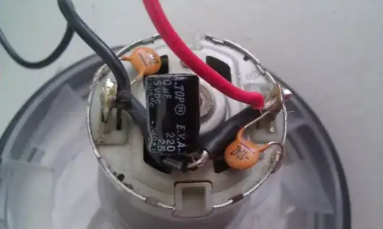

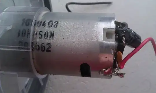

So I thought to simply try it out: I hooked up the + of the battery to the - of the motor and vice versa. The motor did in fact move, but still in the same direction and a lot slower. Unfortunately, after a few seconds it smelled like something was burning. So I quickly took the load of the motor. Luckily it still works..

  1. What kind of motor do I have (see pics below)?
  2. How do I reverse this motor?

The components on the back of the motor are three capacitors to suppress the contacts, and a diode to protect whatever switched it from a back-emf.
If you reverse the polarity without removing the diode, then you will just put the current through the diode not the motor, and possibly either destroy it or damage your power supply, or both.
So you need to remove the diode, and if you are using a simple transistor to switch the motor, provide some other protection. If you're using an h-bridge with diodes, then you're ok (I'd imaging the gert-board does, but don't know for certain).
You also need to remove the larger black capacitor - it is polarised, so will be damaged and possibly explode if you connect it the wrong way round. Previously the diode prevented the current going through it when you did that. If the motor generates lots of electrical noise when you run it without the capacitor - interfering with radios and so on - then you will need to add a similar value of non-polarised capacitor to suppress that.

  • Thanks for the answer! Since your text is quite a challenge for me I hope you can clarify a few things. (1) Which part is the diode? On wikipedia I read that diodes always have 3 connections, but I don't see anything with 3 connections. (2) On this page it says the Gertboard has an built-in H-bridge motor controller. It doesn't say anything about diodes though. Does an H-bridge imply that it has diodes? – kramer65 Mar 18 '13 at 14:38
  • @kramer65 I can't seem to find a schematic or bom for the board - it probably does, given that it's using a h-bridge IC. If you look up the number on the h-bridge IC ( vertical ic with a metal tab, several pins near the fuse ), then the data sheet will tell you. – Pete Kirkham Mar 18 '13 at 15:08
    I went to an electronics shop here in Amsterdam, and there they simply cut the wire connecting the middle black thing (capacitator) on the two sides. And now it indeed runs both ways (without significant noise)! You are also talking about removing a diode; which one are you talking about here? And finally, I found the documentation for the Gertboard (link). It says it is for a brushed DC motor, am I okay with this one? – kramer65 Mar 18 '13 at 18:15
  • Perhaps. We can't really know the current draw of your salvaged motor to tell if it is within spec of the Gertboard's driver. – Chris Stratton Mar 18 '13 at 20:13
  • @kramer65 The photo shows two black components connected across the terminals - a vertical cylinder with writing on it (TOP (R) EVA 220uF 25VDC) and a strip pointing at one terminal and below that a smaller horizontal cylinder with a black band at one end. The larger one is the capacitor, the smaller one is the diode. It's likely that the shop removed both. – Pete Kirkham Mar 19 '13 at 09:14

You have a permanent magnet DC motor,most likely with carbon brushes.
This would normally be reversible simply by reversing its supply connections, as you first tried (after removing or reversing the diode and big capacitor as Pete recommends.
However it is likely that the motor is tuned to run in one direction only.
This is done in a brushed motor by rotating the brushes in the direction of rotation (a little bit like advancing the ignition on an IC engine) so that the magnetic field builds up in time to do the most good. It also reduces sparking when the brushes break contact. Looking at the motor, there is a slot through which you can observe the brushes : check for visible sparking both ways round. It may also be possible to adjust the brush position through this slot with a suitable tool, if you are brave enough.
However, even if the motor will run backwards well enough, it is driving a ducted fan. The curved blades will stall when reversed, and deliver a fraction of the expected thrust, possibly consuming higher than normal current. Check the current on the bench. The reduced thrust may or may not be a problem in your application...

  • Most small DC motors are bidirectional. They reduce armature reaction by shaping the field poles with less air gap in the middle, although that one appears to be tuned for 1 direction. One way to tell (as long as the case doesn't have holes between the poles on 1 side) is to line the armature up so one commutator slot is under the middle of the brush. Tap the ends to allow the armature to line itself exactly. Connect a millivolt meter to the motor and stick a powerful magnet directly over one of the poles. There should be little or no pulse unless you stick the magnet a bit to one side. – Peter R. McMahon Oct 14 '20 at 05:20
  • That method might not work with a 3 segment commutator unless there is a lot of offset. A better way might be, after allowing the armature to line itself up, to look in if possible & check that the slot is still in the middle of the brush. – Peter R. McMahon Oct 14 '20 at 06:10
The motor in the question has an electrolytic, polarized capacitor, and a diode, across its leads - this in itself clearly says that the motor was not supposed to be driven with reversed polarity. The capacitor in question is the black can.
The burning smell was either the short-circuit through the diode frying your wiring, or if the diode had already failed, the capacitor getting extremely upset at being connected to an inverted polarity. You may have been fortunate in that electrocaps tend to explosively express unhappiness at being connected the wrong way around. The white strip on the capacitor casing, seen at the left edge of the capacitor in the last photo, indicates the negative voltage connection.
That the motor moved at all in reverse seems to indicate that the diode had already blown, and the power the motor was receiving was whatever was left over after leakage across the reversed capacitor - not much. That may explain the slow reverse rotation.
Do not use that motor even with the correct polarity before replacing that capacitor and the diode. Further, check if the motor can run acceptably in reverse at all, as the other answers have pointed out.

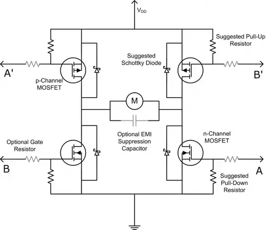

For operating a DC motor in either direction, use a H-bridge circuit:
MOSFET H-bridge (Source)
Instead of discrete MOSFETs or transistors, you can also use a H-Bridge IC such as the Freescale Semiconductor 5 Ampere H-bridge MC33887 or Texas Instruments DRV8837, so long as the voltage and current requirements of your motor are met by the IC selected.
Also, replace the capacitor with an unpolarized one (for electromagnetic noise suppression, if this is necessary), remove the diode from the motor leads and use 4 suppression diodes at the H-bridge terminals, as shown in the above diagram.

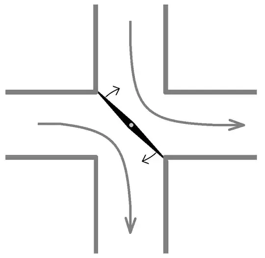

Our old Whirlpool washing machine had a reversing valve like this on the water pump to reverse flush the filter & empty the machine.enter image description here
  • A simpler way would be to get a length of plastic drain or sewer pipe with the wide end for the next pipe to fit in, or put a coupling on it. Mount the motor in a small piece, with the electrical terminals on the side, and jam it in one way for suck, and the other for blow. – Peter R. McMahon Jan 28 '21 at 01:41
