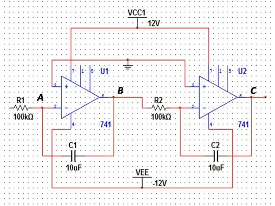

I am working on Double integrator circuit as below (to simulate a physical system for my project on control system performance): enter image description here
The actual input to point A is expected to take values from -2.5V to +2.5V. The circuit (physical one) is not working as expected, which has me guessing on the location of possible fault in it. Replacing both OPAMPs (UA741CP) and checking the capacitors(C1 and C2) didn't help much and now my doubt lies on the polarity of these capacitors (which sadly I didn't notice while taking over the circuit). As my input range is both negative as well as positive i am not sure about them. Could some one help please.
Secondly, given the circuit, if I want to check the individual integrators, by applying signal to A (DC pulse train maybe?) and monitoring output at B for IC1 (one on the left) and similarly at respective points for IC2 (pardon for not having marked). Should it work, or having been connected the circuit behaves differently as opposed to two integrators in isolation. Pardon my parlance for I have not much of electronics background. Thanks

  • Have you simulated the circuit? (there are numerous tools available, some free). There are many non-polarised capacitors available, and single polarised devices are not suitable for this circuit. – Peter Smith Sep 07 '16 at 11:03
  • @PeterSmith : Although I haven't, but this circuit has been working previously. Hence my suspicion on a 'fault'. – sherinkapotein Sep 07 '16 at 11:22

Note: I assume below that your expectation of voltages at point A being +/-2.5V actually refers to the left side of the 100K resistor. Point A should not be more than a few mV either side of ground until the integrator output rails, at which point it should gradually (exponentially) approach the input voltage with time constant 1 second.
The circuit you have shown is correct and should work properly. You should use non-polarized film capacitors for this application. Mylar is acceptable if really high accuracy is not a high priority-- they have significant dielectric absorption (DA) which will cause errors in the sub-1% region.
If you are using polarized electrolytics they will not operate properly when the voltage reverses. You can get bipolar electrolytic low-leakage capacitors which will work okay, but it's better (and probably easier for small quantity) to just get film caps. You could also do a quick test with two polarized 10uF caps back-to-back but it's not going to work very well (Edit: the effective capacitance will be 5uF so you can either use 200K resistors or use 20uF caps).
Ceramic capacitors are another possibility, but the accuracy will likely be terrible because they have a large (negative) voltage coefficient, so your integrator will curve faster as the output deviates from 0V (for a fixed input voltage) rather than following a straight line.
To test the circuit, observe the output voltage of each integrator with a fixed input voltage of (say) 0.1V applied, then reverse the input voltage. The output should ramp at 0.1V/second until it rails at about +/-10V, so it will take about 20 seconds to ramp from one rail to the other.
If the output is at (say) +10.5V, then applying +0.1V should cause it to ramp downwards until it gets to about -10V. It's easier to break the connection between the two integrators at point B and test each one separately. Any deviation from linearity will likely be a result of capacitor imperfections (leakage or DA).

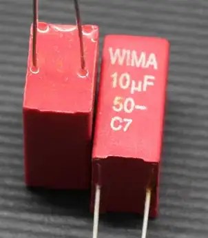

  • Those WIMA caps look good and expensive.A better opamp would support say 1 meg resistors and say 1 microfarad caps. This may be overall cheaper. – Autistic Sep 07 '16 at 11:16
