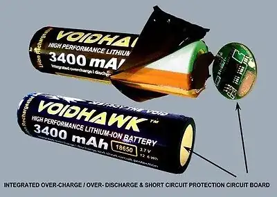

And that when it goes below 3V a microchip disconnects the battery to protect it from discharging too far.
That's true, for batteries that have built in protection circuits. Not all batteries do. Most Li-Ion batteries are raw cells that do not. The ones that do will be slightly longer than the raw cells.
There is also circuits for multiple cells, and in various variations of externally visible or not. You can purchase the cells with the protection built in or purchase the circuits by themselves. Not just for 18650, all form factors of Lithium cells can have them.
You obviously have a non-protected cell, and because you didn't add a low voltage lockout, drained it beyond the safe limits.
