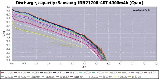

Now compare that graph to this test of a 'high capacity' cell of the same size, also rated for discharge down to 2.5 V:-
The thinner plates in this cell have higher resistance, so it doesn't handle high discharge currents well. The voltage 'knee' is also much softer, with significant capacity remaining below 3.3 V. For this cell a cutoff voltage of 3.0 V would be realistic, while discharging all the way down to 2.5 V might just meet its rated capacity of 4 aH.
Another thing to note about these discharge curves is the 'bump' that occurs before the final nosedive, particularly noticeable at low current. This indicates changes in the chemical reactions occurring in the cell, which may result in increased wear and reduced cycle life beyond this point. In both of these examples the 'bump' occurs just below 3.5 V. This suggests 3.5 V might be a better cutoff voltage for low drain applications.
Device manufacturers often choose a higher "empty" voltage to increase cycle life. This reduces realizable capacity, but total capacity over the cell's lifespan is often dramatically improved because the cell gets damaged less on each discharge.
