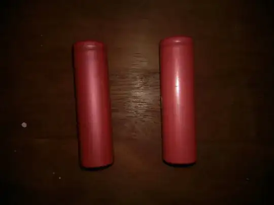

Hi I've have a couple of batteries of these two types, some of them are below 2,5V making me unable to make a CAP test on them, whenever I try my Foxnovo 4-Slots Intelligent Battery Charger beeps four times and "seems, not sure" to remove some voltage from the battery?

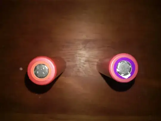

The one with the purple top has "A NJGA59 034688" written on it. The one with the orange top has "C IEOFJT4 077773" written on it.
They come from a semi-old dell laptop battery, from Toshiba and Sanyo I believe.

These are the classic 18650-type OEM batteries, Li-ion chemistry, charge voltage should be 4.2 V. Their design capacity might be 2500 - 3000 mAh, depending how long ago the were made.
If some are "undervoltaged", below 3.0 V (or even to zero), you can try to recover them by applying "pre-charge" current, 100 - 200 mA, until they get to 3.3V-something, then a normal charger will work. Be aware however that the battery capacity might be substantially reduced, down to 20 - 40%, or it could remain dead.
