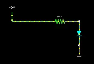

  1. Source -> Resistance -> LED -> GND

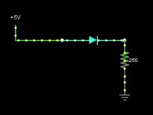

  2. Source -> LED ->Resistance ->GND
For the 1st configuration
If we measured the voltage drop across the resistance it will be 3.3 V So your source provided 5 V , 3.3 V dropped across the resistance and 1.7 V dropped across the LED (Forward voltage) The sum of the voltage drop across the circuit elements must equal to 5 V (3.3 + 1.7) Not more or less than 5
For the 2nd configuration
Same this will happen (1.7 V dropped across the LED , then 3.3 V are dropped across the resistance
So it DOESN'T matter where is the resistance as long as its connected in series with the LED

As explained, it would receive the same voltage either way, but an experienced engineer would say there is only one correct way to normally do this. The LED should be connected to ground, with the resistor between it and 5 V. The resistor has two functions. The first is to set the amount of current into the LED in normal use, as you have imagined.
The second is to protect the circuit from accidental damage. If you are working on this circuit, you might be using something like an oscilloscope that has one clip lead that is normally ground. If you connect the LED to the 5V, and accidentally touch the other end with ground, you will have no current limiting and may burn out the LED.
If you connect the resistor to 5 V, and the LED to ground, then touching the connection between them with ground draws more current through the resistor, but the LED gets no voltage since it is now grounded on both ends, draws no current, and therefore no damage is done.
