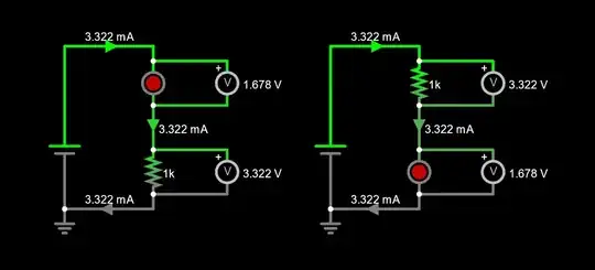

Here's a quick sim to show what's up (simulate it here):
You'll notice in each case that:
  • LED forward drop is the same
  • Resistor IR drop is the same
  • The currents are equal everywhere
The only difference we see is the voltage between the LED and resistor, since that shifts with the component order.
