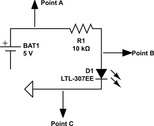

I am an electronics beginner and I created a small little circuit, just a battery a resistor and a led, then to ground. This is the circuit:
schematic
Now I have a few questions about it. I know voltage is the different of electrical charge between two points, so I measured that difference:
Point A to B: 3.27V Point B to C: 1.82V
  1. First question: Does that mean that the actual voltage of: Point A: 5V Point B: 1.73V Point C: 0V?

    "the actual voltage". Voltages aren't absolute, they are the difference in potential between two points. If by "actual" you mean, "referenced to point C", then yes. – Tom Carpenter Aug 23 '16 at 02:18
    Your diagram doesn't show a circuit. Having read the answers, do you understand why? What do you need to add? – Neil_UK Aug 23 '16 at 05:14
  • No. ...................................... – Russell McMahon Aug 23 '16 at 15:40
  • @Neil_UK is it become the circuit doesn't have anything connected to the negative end of the battery? can't ground replace that? – ptt Aug 23 '16 at 20:31
    @Pablo Yes, and yes. So if you want to show a circuit, edit your schematic to put a ground symbol on the -ve end of the battery. Even if you have actually made a circuit, you haven't drawn what you have made, you've drawn something else. This will confuse your readers. – Neil_UK Aug 24 '16 at 05:15
The resistor and LED are in series. It doesn't matter for the purpose of lighting the LED what order they are in.
You are confusing voltage and charge. What you are looking at are voltages. That's not the same thing as charges.
Voltages are relative to each other, like your A --> B, B --> C, etc. Ground is a name we give to that one node in a circuit that we implicitly consider to be at 0 volts. Then we can pretend other voltages are absolute, although they are really relative to this ground node.
In radio and some power applications, ground can also mean true earth ground. However, that doesn't apply to your circuit.

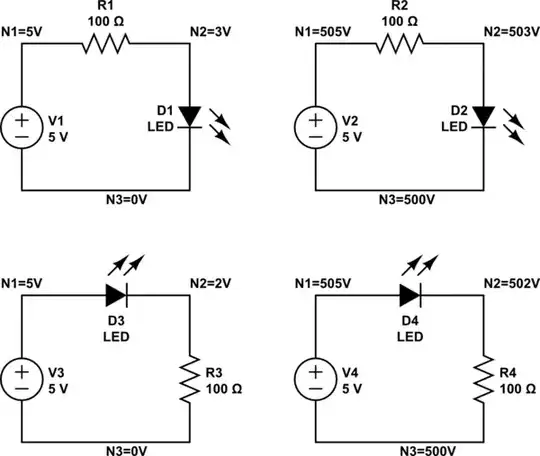

So, let's look at "LED cooked four ways:"
schematic
In the above circuit, I assume that the LED requires \$3V\$ when operating with \$20mA\$ and that resistor \$R_1\$ is designed to limit the current by the formula, \$R = \frac{V_1 - V_{led}}{I_{led}=20mA} = \frac{5V - 3V}{20mA} = 100\Omega\$.
Note that no matter how you look at it, the two nodes on either side of the LED itself are exactly \$3V\$ apart. The two left side panels show \$N_3\$ as \$0V\$, as is often done by convention. In any circuit, you get to set exactly one node (or wiring point) to any value you like. (The rest you don't get to do that with.) Most folks call it \$0V\$ to help simplify things a bit, mentally. (Sometimes, it does mean more than that. But that's a different discussion.) Or just ground. However, as you can see in the right side panels, I've decided to call that wire (node) \$500V\$ instead. It doesn't matter what number I assign it. I could make it a million volts or minus a million volts. The point is that it doesn't really matter, so long as all you are focused on is the circuit itself.
It will matter, though, if a circuit is connected in some way to other circuits. But for any local schematic where you are ignoring the rest of the universe while looking at it, then it's all relative.

Since your drawing does not show a complete circuit (the negative terminal of the battery is not connected to anything), no current can flow, so there can be no voltage drops across any component.
In most circuits, "Ground" is just the point that we choose to call "Zero Volts", and use as a reference when measuring voltages elsewhere in the circuit. It has no special "magical" properties - it is just a label we place for our convenience. These days, "Ground" is usually chosen as the most negative point in the circuit, but it could instead be the most positive. For many audio and linear circuits, Ground is the mid-point of the power supplies, and we have both negative and positive voltages in the circuit.
So, with no current flowing, thus no voltage drops, all points in your drawing are at Zero volts, except the negative terminal of the battery, which is at -5 volts.
If you intended the negative terminal of the battery to be connected to Ground, then your voltage reading would make sense.
By Kirchoff's current law, the current is the same at all points in a simple series circuit, as you attempted to draw, so it makes no difference what order the components are connected.
