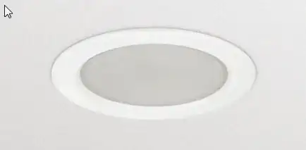

Figure 1. The 220 - 240 V, 9 W Philips downlighter has an overall diameter of 84 mm.
I thought he was mistaken but he linked to the Philips DN135B LED6S/830 PSR-E II WH datasheet and it states that the inrush for this 9 W lamp is 7 A for up to 300 ms.
Can anyone think of a reason the PSU in these luminaires could draw 1.75 kVA for up to 300 ms when the lamp is only 9 W with a 0.9 power factor? Where is the juice going?

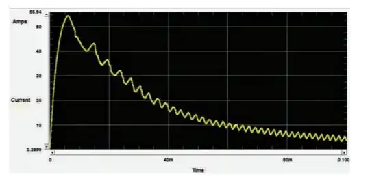

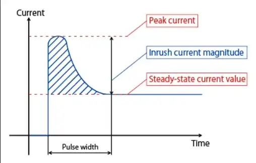

I don't see much contradiction. Inrush current is usually an exponentially decaying spike. The "7A" nameplate value is certainly the peak current. The "300ms" is likely a nameplate for spike duration, probably defined at 10% level, so the total energy is much lower than the bold estimation. Here are "definitions" from Murata:
where the duration looks like is defined at 0% level :-)
There is a line-up of technology and tutorials that deals with inrush current measurement, like Keysight
Let me guess some numbers from the Philips datasheet.
If the input has 7A at 240 V peak, the ESR looks like about 35 Ω. If the 300 ms is defined as RC constant, then the capacitor might be (35 * C = 0.3) C =8,500 uF, which sounds too high. So the 300 ms is likely defined differently in the area of industrial lighting.

  • Keep in mind the inrush graph is for a power supply to a motor. AC inrush to non-dimmable AC power LED depends on the phase of the start voltage. So the worst case inrush unless limited otherwise well depend on phase, cap ESR etc. – Tony Stewart EE75 Sep 22 '18 at 22:56
