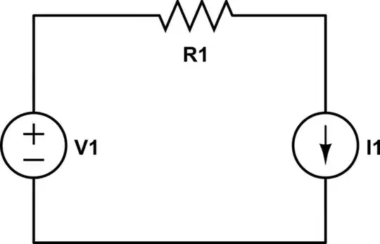

Example 1
Take this circuit with two sources:
schematic
I want to solve for the current J flowing through R1.
Pick V1 as source 1, and I1 as source 2.
Solving for \$J_1\$, the circuit becomes:
schematic
simulate this circuit
So we know that \$J_1 = 0\$.
Now solving for \$J_2\$, the circuit becomes:
schematic
So we can find that \$J_2 = I_1\$.
Applying superposition, \begin{align*} J = J_1 + J_2 = 0 + I_1 = I_1 \end{align*}

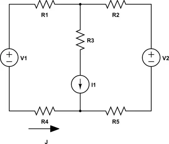

Example 2
schematic
Now I am interested in the current through R4 \$J\$. Following the general process outlined earlier, if I denote V1 as source 1, V2 as source 2, and I1 as source 3, I can find:
\begin{align*} J_1 &= -\frac{V_1}{R_1 + R_2 + R_5 + R_4}\\ J_2 &= \frac{V_2}{R_2 + R_1 + R_4 + R_5}\\ J_3 &= -I_1 \frac{R_2 + R_5}{R_1 + R_4 + R_2 + R_5} \end{align*}
Thus the final solution is: \begin{align*} J &= J_1 + J_2 + J_3 = \frac{V_2 - V_1}{R_1 + R_2 + R_4 + R_5} - I_1 \frac{R_2 + R_5}{R_1 + R_2 + R_4 + R_5} = \frac{(V_2 - V_1) - I_1 (R_2 + R_5)}{R_1 + R_2 + R_4 + R_5} \end{align*}
The power of superposition comes from asking the question "what if I want to add/remove a source?" Say, I want to add a current source I2:
schematic
Instead of starting over from the beginning, the only thing I need to do now is find the solution for my new source I2 and add it to my old solution: \begin{align*} J_4 &= I_2 \frac{R_1 + R_2 + R_5}{R_1 + R_2 + R_5 + R_4}\\ J &= \sum_{i=1}^4 J_i = \frac{(V_2 - V_1) - I_1 (R_2 + R_5) + I_2 (R_1 + R_2 + R_5)}{R_1 + R_2 + R_4 + R_5} \end{align*}
