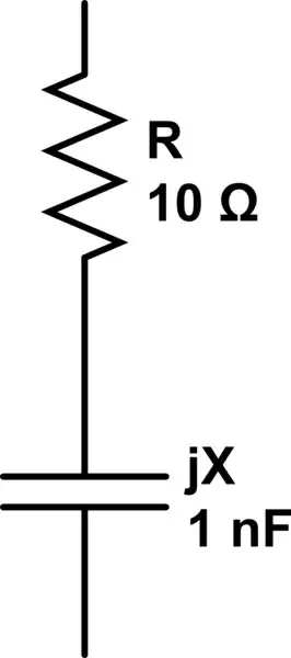

I'm not looking for complex explanations on transducer modeling, rather lets assume we have a very simplified transducer model of basically an R and C in series:
schematic

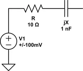

On the transmit cycle the circuit will basically look like this with the transducer as a load:
schematic
simulate this circuit

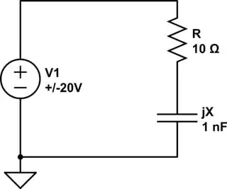

However, on the receive cycle, it's not immediately intuitive to me how to model the transducer as a voltage source with the given impedance model. Is it simply a voltage source with the impedance in series like this:
schematic

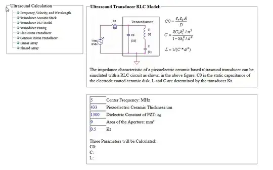

Assuming you are talking about a piezo transducer, there is a strong inductive component (like a tank circuit) because of the mechanical resonance.
This site has a simple model of a piezo transducer:
There are actually going to be multiple resonances in many cases- the above model is for a thickness resonance. Audible-frequency to ultrasonic transducers use a bending mode, so the calculator on that page will not yield useful results for such a transducer.

  • As I mentioned, lets assume we know what the transducer model is. This also implies that we are operating at a single frequency. The website you linked explains the transducer as a load. What I'm asking is, if we know what the transducer's impedance is as a load, what does is the circuit model when the transducer is acting as a voltage source? IE, when it is receiving a sound reflection as opposed to transmitting. – user137089 Apr 10 '17 at 14:05
  • @WhL Assuming the voltage represents displacement I think it acts as a voltage source in series with the main transducer capacitance. Unless you run it into a short circuit (and have a very low series resistance) that resonates with the 'inductance', so that you get a voltage envelope that increases with time, particularly when you are near the mechanical resonance. There needs to be a damping factor in the model too (a parallel resistor), for it to be remotely realistic. That should correspond to the mechanical Q. Displacement may (or not) be proportional to force to sufficient accuracy. – Spehro Pefhany Apr 10 '17 at 14:43

During the receive period, at frequencies significantly below resonance you can model the transducer as a capacitor (simple capacitance which is measured significantly below resonance) in series with a voltage source.

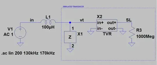

Putting it all together: LTspice schematic
LTspice schematic
L1 is a series tuning inductor (optional)
X1 is the transducer admitance (impedance)
X2 is the transducer transmit sensitivity
SL is the source level of the transducer.
TVR is Transmit Voltage Response, terminology used in underwater acoustics.
