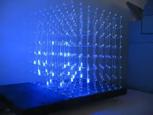

There's a very nice, detailed tutorial here which includes a section on using an Arduino to run an 8x8x8 LED cube. (Don't miss the YouTube movie they have up)
