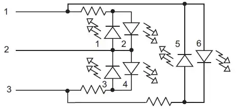

12
Using Charlieplexing you can directly drive \$n \times (n-1)\$ LEDs from \$n\$ pins.
Exemple:
Six LED's on 3 Pins:
PINS        LEDS
0 1 2   1 2 3 4 5 6
0 0 0   0 0 0 0 0 0
0 1 Z   1 0 0 0 0 0
1 0 Z   0 1 0 0 0 0
Z 0 1   0 0 1 0 0 0
Z 1 0   0 0 0 1 0 0
0 Z 1   0 0 0 0 1 0
1 Z 0   0 0 0 0 0 1
0 0 1   0 0 1 0 1 0
0 1 0   1 0 0 1 0 0
0 1 1   1 0 0 0 1 0
1 0 0   0 1 0 0 0 1
1 0 1   0 1 1 0 0 0
1 1 0   0 0 0 1 0 1
1 1 1   0 0 0 0 0 0
Schematic of Charlieplexing with 3 output pins
