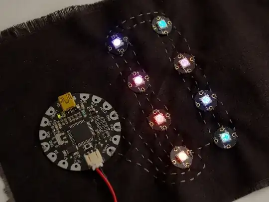

The idea already exists: Several companies offer ready-made LED chains which can be controlled through a single pin (see for instance here). These purpose-made LEDs have 4 pins: Two for electricity and two for receiving and transmitting a signal. If I understood it correctly (and please correct me if I am wrong), this is simply a serial shift register: Bits are pushed through the system until all are in place, then only requiring a latch signal to activate them.
However, in my case, the buzzers I intend to use have only the electricity wires and have no way to be chained together, yet controlled separately. So this got me thinking: Can I, through simple means/tools, construct my own chain which I can address through a single pin on the Arduino? If so, what would I need to do & buy to accomplish it? In essence, what I am trying to achieve is maybe captured in this picture.

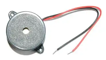

From your question I think you have one of those black plastic buzzers in mind that has two wires?
If you restrict your design to 3 wires (daisy chained through all buzzer locations) you won't escape from having a chip at each location. Once you have a chip you will need a PCB. There are much smaller buzzers/speakers than the type you have in mind that can be mounted on a PCB. Put a small < $1 micro-controller (a PIC 10F200 would do, but I would prefer a small Cortex M0) and you can program it to do exactly what you want, including beeping at various frequencies etc. But this does require some programming!
