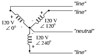

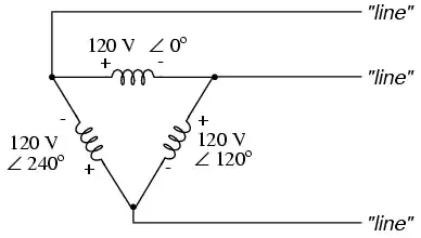

It's all to do with how the power is transformed from high tension to normal mains voltages.
The power is transmitted across the country in 3 phases. There are two types of 3-phase electricity - star and delta. Delta uses 3 cables, and the power is split between them 120 degrees out of phase. When it comes to your local substation the power is fed through a transformer which switches it to "star" 3-phase. In this arrangement there are 3 live (or hot) wires and 1 neutral. The 3 coils of the transformer are linked together at this neutral connection, and, in relation to the other three lines, it has zero power. It is neutral. Very often this is also linked to earth at this point as well.
Star:
Delta:

    +1 for some excellent diagrams as well. However I still feel the question is unanswered. If I understand correctly, at the mains power for a given wall socket, the hot is one of the three phases, and neutral is neutral. If neutral is tied to ground, then why are neutral and ground separate? – JYelton Jun 09 '11 at 23:01
    Ground is a local connection, neutral is a remote connection. The purpose of neutral is to complete the circuit to the substation. The purpose of ground is (among other things) to cause a large current to flow in the case of a fault triggering an over current device (fuse) to blow. Ground is connected locally just outside your house (it sometimes has a link back to the substation as well, known as "PME"). – Majenko Jun 09 '11 at 23:06
  • @Matt thanks for that! That helps make the purpose of neutral vs. ground much more clear. – JYelton Jun 09 '11 at 23:19
    Ground is intended to be 'safe' in that it should never carry any current unless there's a fault. If AC ever gets routed to the ground, there should be high-enough current drawn to quickly activate a protection device (a fuse, breaker, etc.) and render the circuit safe. – Adam Lawrence Jun 09 '11 at 23:37
  • The similarity between the images suggests that they use the same voltages, and therefore it would make more sense if the delta voltages were 208V ($120V \times \sqrt{3}$ – stevenvh Jun 26 '11 at 07:29
  • $Vl = \sqrt{3} \times Vp$ – Majenko Jun 26 '11 at 08:38
    Instantaneous voltages of each phase: $Vr = Vp \times sin(\omega t), Vy = Vp \times sin (\omega t - 2 \pi / 3), Vb = Vp \times sin (\omega t - 4 \pi / 3)$ The sum of $Vr + Vy + Vb$ should equal 0. – Majenko Jun 26 '11 at 08:41
