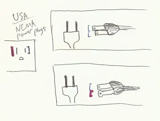

I was wondering what advantage is gained by modeling a power plug after the lower design. These are American power plugs, and they both exist.
Perhaps the only consumer-based effect gained by using the upper plug is that the plug can be put in upside down, which is helpful when using big, bulky wall warts.
I know that electricity-wise, the orientation really doesn't matter, and that the options below don't matter if there is a ground pin. The ground pin will limit the orientation to the upright position.
However, I can't really think of a solid advantage gained by the lower option.
Also, why are there sometimes holes in the end of the plug? I think that they may exist to save metal.

    I don't really understand what you're asking here. It appears you've designed a new plug, yet can't think of any advantages to using it? Why have you proposed this new design then? Can you also describe what is different between the two designs - it looks the same but the lower one has a larger end to one of the pins (or is it the same size, but the stem of it is thinner?) It's all a bit unclear really. –  Aug 21 '13 at 07:49
    They exist already. I didn't make them up. The lower design has a taller left pin (that is the only difference) to accommodate the taller slot in a power socket on the left side. Anyway, I made the picture better. When you have the chance, can you check this out? Thanks. – Blue Ice Aug 21 '13 at 13:08
  • And, no, the bottom design does not have pins that are closer together. – Blue Ice Aug 21 '13 at 13:11
    I think the lower plug is used where polarity is important. –  Aug 21 '13 at 13:52

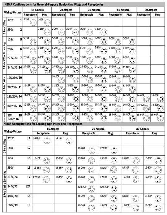

The National Electrical Manufacturers Association (NEMA, USA) has set standards for configuration that differ depending on current rating (15, 20, 30, 50 or 60 A) and electrical potential (120, 208, 240, 277, 480 or 600 V)*. This has resulted in more than 35 different straight blade configurations (various grounding systems included).
From Museum of plugs and sockets
The system rules out accidental intermating of devices and related risks.

The only NEMA plugs and sockets I could find (here is a chart) that fit the description in the question are the NEMA 1-15 (15 Ampere) and 2-30 (30 Ampere) formats:
NEMA 1-15:
NEMA 1-15
NEMA 2-30:
NEMA 2-30
(source)
Both formats are designed for the second type of plug described in the question:
Plug
This ensures that the "hot" or "live" line is correctly connected to the "hot" or "live" side within the appliance, not that it should matter for a 2-wire AC mains connection.
The non-polarized version of this plug works in either orientation, so it'll still fit the polarized socket, but without "hot" guaranteed to go to some hypothetical "hot" inside the device:
Plug
Since low-power 2-wire equipment often works under the assumption that neutral is equivalent to building earth, the polarity affects only such applications where such a "neutral" being exposed to touch is a concern.
For typical household equipment that uses an isolating power adapter / isolated switch mode power supply, this polarity issue becomes moot, hence the convenience of a plug that works in either orientation simply saves some aggravation when plugging an appliance in, in a dark room or in a hurry. I can see the merit of that.

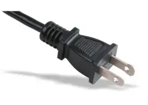

The difference in blade width is for polarity. The wider blade is for ACN (neutral) and the narrower blade for ACH (hot). Wikipedia AC power plugs and sockets in the section for "North American and IEC 60906-2, NEMA 1-15 (15 A/125 V unearthed) (Type A)" states:
Initially, both blades were the same width, so the plug could be inserted into the socket either way around. Plugs manufactured since the 1950s are polarized; the neutral blade is wider than the line blade, so the plug can be inserted only one way. Polarized NEMA 1-15 plugs will not fit into unpolarized sockets, which possess only narrow slots. NEMA 1-15 plugs will fit NEMA 5-15 earthed sockets, which have a wider slot for the neutral blade. Some devices that do not distinguish between neutral and line, such as internally isolated electronic power supplies, are still produced with unpolarized narrow blades.
Regarding the holes, according to HowStuffWorks They are to help maintain the grip in the socket, allow a plastic "lockout tie to be inserted at the factory", and to save metal.
