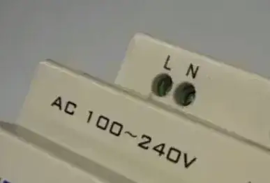

Even though AC has no polarity, almost all the power supply AC inputs or most AC powered device input terminals indicate line and neutral terminals as L and N just like in the following example:
Is there a fundamental reason to wire line to L and neutral to N but not the other way around? Could you give an example what might go wrong if one connects neural to L terminal and line to N terminal?

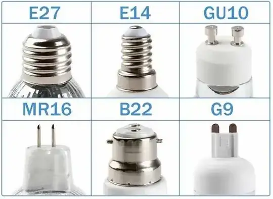

One example where Live/Neutral does make a difference are some lamp fittings. For E27 and E14 fittings the "screw" part is more likely to be touched by the user when changing the lamp. That means that the screw part should connect to the neutral instead of live.
The other fittings are symmetrical so there is no difference.

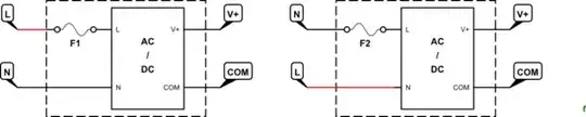

One reason is that typically the internal fuse is on the live wire. In the event of a catastrophic internal failure causing a short to the PSU output the circuit will be dead when the fuse blows. With reverse connection the fuse might not blow and even if it did the internal circuit would be live.
schematic
Figure 1. Left: correct. Right: incorrect.
