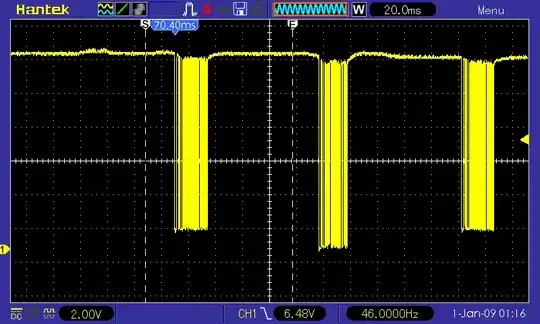

  • There are three distinct messages that occur when the button is pressed. Notice the voltage is lower on the middle message. I suspect that this might be some sort of confirmation from the opener, and the first and third messages are from the button. enter image description here

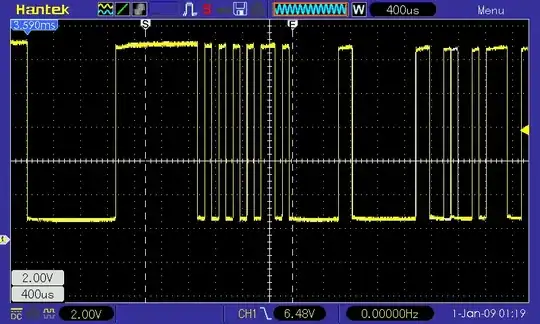

  • The message seems to have the same header, but the content changes slightly. Here are two back to back overlaid enter image description here

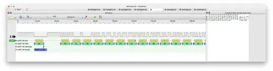

Edit 3 I found a program called sigrok PulseView which has a uart decoder plugin. I tested a bunch of recorded samples and found some consistencies which leads me to believe that
  1. It is in fact uart 9600 baud as @Jasen originally suggested
  2. I do not know if its LSB or MSB. I left the default LSB decoding in from PulseView
  3. The data is obfuscated or encrypted and this is a dead end for now
pulseview

  • Unfortunately, the middle signal may be a "challenge" from the door control, asking the client to prove they are who they pretend to be. The client needs to respond appropriately to the challenge, which may change on every occasion, thus defeating playback attacks. – Math Keeps Me Busy Dec 15 '21 at 17:05

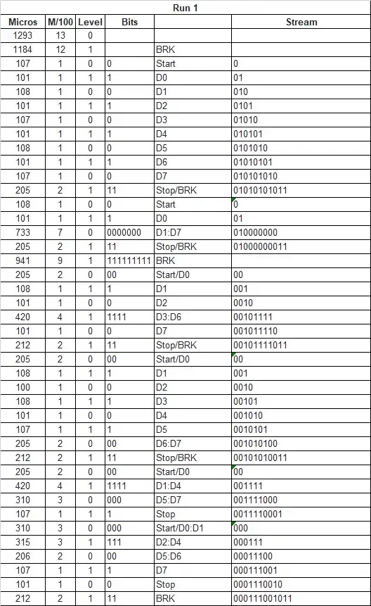

I doubt that playback will work. My guess is the protocol uses a similar protection as the rolling code method, and the initial character is identical each time. @Jasen said it is UART protocol, which I agree, from the newly decoded values for Run1. At least the first six characters seem to be error free (break/start/data/stop). Breaks can be any length of time.

Apart from the first pulse which is over-length, it looks like asynchronous serial with 8 data bits and two stop bits. The evidence for this this is the regularly spaced two high followed by 1 low. (so 11 bits per symbol)
The baud rate is a little over 9600 baud (I get 9620 but the precise value depends on how good the clock on your Arduino is, in any case it's close enough to 9600 to call it 9600).
Connect it to a UART and you'll see a "break" symbol followed by a brief pause and several data symbols.
I don't know what the actual data bits mean
