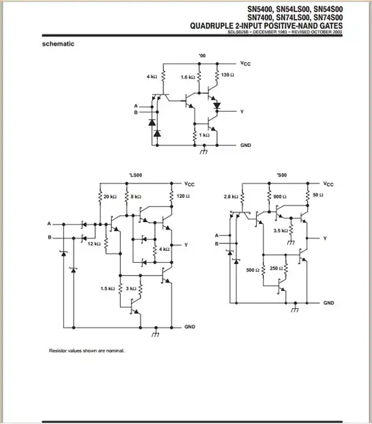

Have a look at the simplified diagram of a NAND gate from wikipedia. You can see that a current can flow from Vcc trough the base and collector of the first transistor to the base of the second transistor and switch it on.

From TI's TTL NAND data sheet, reproduced below, it can be seen that with the inputs (A,B) either both high, or allowed to float, current will be allowed to flow into the base of the totem pole driver, eventually driving the output (Y) low.
However, when either A or B is pulled low, the current which would flow into the base of the totem pole driver is, instead, diverted to ground, forcing Y high.
