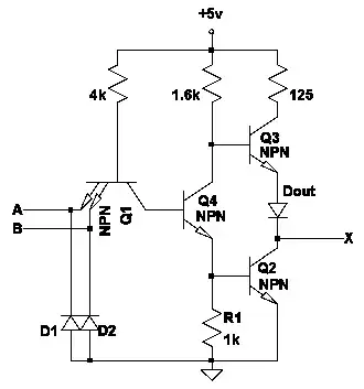

  • This is the internal circuit of a 7400 TTL NAND gate. If you leave A and B open, current flows via the 4kΩ resistor (top-left) through the base-collector junction of Q1. This makes Q4 conduct. The same happens when A and B are wired to +Vcc. For TTL gates there's therefore no difference between an open input and an input tied to +Vcc.
