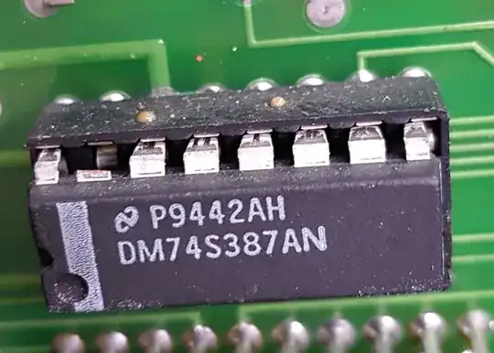

I am trying to understand (and fix) a soda machine that doesn't seem to accept 1€ and 2€ coins while all stickers (inside and outside) seem to imply that they should work (5ct to 50ct do work).
I noticed that the coin validator (class "MS 1000" by Mars Electronics International) has a broken pin (see the picture below). According to the PROM's datasheet, that's the A7 pin, but that doesn't tell me anything (I haven't found any documentation on the MS 1000).
I have not yet removed the board from the case because it sits very tight and I don't want to break it, so I don't know whether the pin is connected on the board.
Is that necessarily a problem or is it possible that this is intentional?
Is it advisable to reconnect it?
Picture of the broken pin

This is only a partial answer - I don't know if it is safe, but I do know that it is not a problem.
The issue with the coins was that there was too little change available and the warning lamp was broken. The soda machine works perfectly with the pin disconnected.
