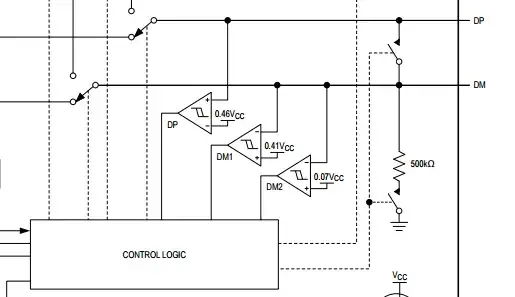

In practice, 'smart' chargers use a special chip called a Dedicated Charge Port Controller. A DCP controller can act like different chargers, and picks the mode which seems to work best.
That's because regular ('dumb') wall chargers use USB's data connections to signal in a static, analog way what they are capable of. 'Smart' chargers can do the same, but in a less static way: they watch the behaviour of the charging device, and deduct from that the ideal setup -- which they can then emulate.
Examples of dedicated charge port controller chips are the Texas Instruments TPS2510 series 'USB Charging Port Controller', Maxim MAX14600 series 'USB Host Charger Identification/Adapter Emulator' and Norelsys NS3601 'USB Fast Charging Port Controller'.
An image from the TPS2513a datasheet (copyright TI): TPS2513A data sheet showing DCP capabilities
An similarly, the MAX14600 (copyright Maxim): MAX14600 data sheet showing DCP capabilities
You can see that the USB data lines ('DP' and 'DM') have several configurable resources on them, and these are controlled by some 'smart' logic.

'Smart' chargers -- i.e. the 'DCP controller chips inside them -- can emulate a standard DCP port with varying resistor values, and can also emulate several of the non-standard DCP voltages.
The secret sauce
The chip manufacturers don't really describe how their 'detection' logic works, but the only option they have is to monitor what the charging device is doing on the D+ and D- lines, and to look at the current that is being drawn.
This no doubt requires a lot of trial-and-error research, and the algorithm is probably kept as a closely guarded secret.
One technique which might be used, is to cycle through the emulated states and noting the amount of current that is drawn. The state with the highest current draw then is the 'best' and remains active.
