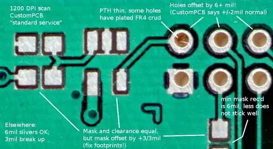

Perhaps this scan of a (rather poorly) commercially made board will illustrate the tolerance issues involved:
commercially made PCB

  • so is the green or the black the mask in this scan? – 300D7309EF17 Aug 22 '18 at 22:12
    @tedder42 The green area is all mask. The black areas are bare board (some under mask and some not). The lighter areas are copper. The shiny silver parts are plated copper not covered by mask. – Ben Jackson Aug 29 '18 at 16:56
