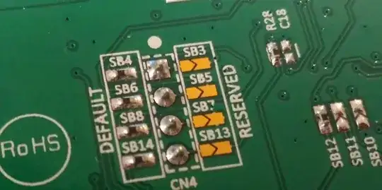

Take this layout:
 |__/ /__|
Just make the arrows better than I did here :D
Slide with solder left to right to close, right to left to open. Reduce the gap to a minimal safety size. I'm sure they're already defined in the standard CAD programs libraries.

    As a bonus, you can stick an SMD resistor on them for automated assembly, as seen a couple times in that picture. – Hearth Sep 21 '23 at 19:41
    Does that really works better that two square pads which you swipe horizontally to close and vertically to open? – Dmitry Grigoryev Sep 22 '23 at 08:30
