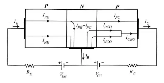

An Active Biased BJT Transistor ICBO = Reverse Leakage Current between Collector and Base while Emitter is Open. (IE=0)
ICEO = Reverse Leakage Current between Collector and Emitter while Base is Open. (IB=0)
IC=BIB+(B+1)ICBO
if(IB=0){IC=(B+1)ICBO=ICEO}
These are two different Leakage Currents for two different ways of Active Biasing of a BJT Transistor.

1/ ICBO is reverse leakage current going from the Collector to the Base. This current is then amplified by β to produce additional Collector current, thus the "1+β" term.
2/ Both currents exist simultaneously, but ICBO is included in ICEO.
3/ The reverse current ICBO is amplified, just like external Base current would be.
Bruce Abbott
  • 56,322
  • 48
  • 93
  • Voltage is only applied between the Collector and the Emitter, but ICEO flows from the Collector to the Base and then to the Emitter. Of course this Base current will be amplified, and the result (ICEO-ICBO) flows directly from the Collector to the Emitter. – Bruce Abbott Aug 10 '14 at 10:28
