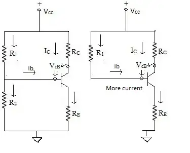

Removing R2 would increase the chances for thermal runaway, there are two "loads" on R1, one is R2 and the other is the transistor. If one "load" is removed than the voltage goes up. If R2 is removed then the voltage Vcb goes up and so does the current Ib. (you could also think of it from a current node perspective and the current through R1 must go through R2 and the transistor, if R2 is removed all the current goes through the transistor, which is a simple way to look at it but it sill works) This would increase current through the transistor because Ib would be higher and so would Ic.

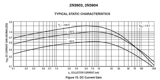

Here is an example of how current gain changes in a real transistor with temperature (the 2n3904). At certain currents (like 10mA) Ic would increase with the temperature increasing. The good thing is the designers accounted for the thermal runaway effects and at higher currents, beta/hFE goes down with temperature at higher currents which reduces the thermal runaway effect. In other BJT's, this may not happen. The most important thing is to avoid reaching the absolute maximum temperature of the part.
enter image description here Source: https://www.onsemi.com/pub/Collateral/2N3903-D.PDF

I think the confusion is that for a PNP this would be true, since we have an NPN. If R2 is removed we have more Ib if R1 is the same in both circuits, more Ib means more Ic and more Ie. This would increase the temperature of the part and wouldn't necessarily cause thermal runaway but could cause thermal runaway by starting the cycle. It would depend on the parts in the circuit.
Now if we start from the circuit without R2 adding R2 would decrease the chances for thermal runaway.
No portion of Ie (what you call Iceo) flows through R2 with an NPN. The directions of currents are indicated above.
Since there is R2 which provides a path to ground, would Ico still flow through base-emitter junction or flow through R2 to ground? Because, to me if it flows through R2 it wouldn't cause thermal runaway. (?)
No portion of Iceo flows through R2. All of Iceo flows through Re. All current in a transistor must exit through the emitter.

  • Sorry, let me clarify, this is an NPN transistor we know this because Re is connected to the emitter. This means that there are two currents that combine to find the emitter currents the equation is Ib+Ic=Ie (which I assume what I call Ie is what you cal Iceo). Iceo goes through Re – Voltage Spike May 15 '19 at 19:38
  • Ib comes from R1 and Ic comes from Rc, the diagram is bad because they don't show Vee or ground on the bottom side and don't show the other currents, but all currents in this diagram will flow through the resistors from top to bottom. – Voltage Spike May 15 '19 at 19:39
  • Adding R2 would decrease the chance for thermal runaway. – Voltage Spike May 15 '19 at 19:56
  • Sadly still not clear because I shouldn't have asked two questions in one. Maybe I shouldn't ask about thermal runaway at all. Lets only focus on the flow path of Iceo. If there is no R2 all the Iceo would flow through emitter resistor. But if there is R2 would all the Iceo flow through R2 or Re or both? I reduced the question to this and if you can answer this it is enough for me. – pnatk May 15 '19 at 21:04
  • Check the bottom of my post, it should answer that portion. No portion of Iceo flows through R2 with an NPN. Normally Iceo is called Ie. I've shown the difference in the circuits with R2 there and R2 removed – Voltage Spike May 15 '19 at 21:05

  • All current through the NPN transistor (like the one listed above) flows through Re, I think that is where you are confused. – Voltage Spike May 15 '19 at 21:32
