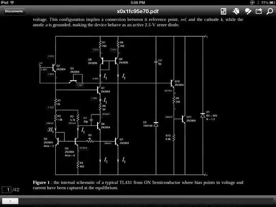

TL431 internal architecure.

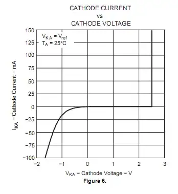

Intenal diode Reverse characterstic.
  1. TL431 can be used to generate voltages from Vref to 36V. Output voltage is taken across diode in reverse biassed condition. reverse characterstics says Reverse breakdown voltage is 2.5V, then how TL431 can generate different output voltages. Diode breakdown region allows more current(Ika) to be taken but reverse breakdown voltage(Vka) will be almost const. I didn't understand physically how it will generate different voltages.
  2. Please explain the operation of the other elements, like When Vref> 2.5V Opamp output will be high, then transistor will be ON and conducts current, but it will not effect diode behavior.
When Ref<2.5 Op-amp output is Low -->Transistor OFF, but it will not affect diode behavior. When the diode will be going to breakdown region?.

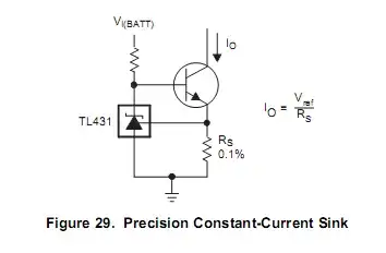

  1. Constant Current source using TL431
Constant Current Source
How to explain this circuit.?
One explanation says, REF always maintained at VREF->2.5V, so, constant current source Vref/Rs ----> How REF always maintained at 2.5V

  • i didn't get answer to my questions...1. Based on REF voltage w.r.t 2.5V, BJT will turn ON or OFF, but no where data about the diode is mentioned.How diode will work here. ....................from Block diagram, across diode only output voltages taken, diode has Reverse breakdown voltage of 2.5V, then how output voltage can vary from 2.5 to 36V?.... – user19579 Apr 24 '14 at 05:25
Start from scratch imagining the transistor isn't conducting. Voltage across Rs is zero and therefore the TL431 is open circuit - but that's a problem because if it were open circuit (off) there would be decent base current into the transistor and Io would be large.
OK, look at it the other way, TL431 is conducting because Rs has enough voltage across it due to transistor being on - hey but this is wrong too because, if the TL431 were conducting there would be no voltage on the transistor base and therefore it isn't conducting and Rs has no voltage across it.
The goldilocks answer - the transistor is just conducting enough to allow 2.5 v to develop across Rs which in turn is just starting the turn the TL431 on and if it turned on too much, the current would reduce thru Rs and this would counteract the TL431 turning on too much.
It's called negative feedback.
Andy aka

  1. The breakdown is more properly "forward breakdown" if you think of it as a zener- the cathode is negative. That's not the normal operating mode, in any case. Normally you want the cathode positive, and by dividing the voltage on the cathode down you can get the IC to regulate at any voltage from 2.5V (no divider) to 36V (maximum voltage).
  2. The voltage from cathode to anode should always be at least Vref, so the circuit will always have some voltage to function.
  3. In the case of the current sink, the voltage at the cathode will be Vref+Vbe (Vbe of the BJT) when it is regulating. The internal transistor shunts the current from the resistor to the BJT base to maintain the reference input of the TL431 at Vref.

In the cited case of generating an output current ("constant current-sink"):
[Note that the drop at Rs is REF, and ANODE is GND (defines 0V)]
It works because if the drop at Rs (REF) is less than Vref (2.5V), then the internal BJT will increase its resistance, shunt less of the base current of the external BJT, so the external BJT gets more base current, which increases its emmitter current, which causes the drop on Rs to increase (so REF increases). Summary: {REF > Vref} makes REF decrease.
On the other hand if the drop at Rs (REF) is higher than Vref (2.5V), then the internal BJT will decrease its resistance, shunting more current, so the base of the external BJT gets less current, so its emitter current is less, so less voltage is dropped at Rs, decreasing RES. Summary: {REF < Vref} makes REF increase.
Therefore, at equilibrium REF = Vref (2.5V). Since the drop on Rs is known, and Rs is known, then the collector current is known, which is your output current. So can basically set the output current by properly selecting Rs (Io = 2.5V/Rs).

  • i didn't get answer to my questions...1. Based on REF voltage w.r.t 2.5V, BJT will turn ON or OFF, but no where data about the diode is mentioned.How diode will work here. ....................from Block diagram, across diode only output voltages taken, diode has Reverse breakdown voltage of 2.5V, then how output voltage can vary from 2.5 to 36V?. – user19579 Apr 24 '14 at 08:28
  • @user19579 If you are referring to the diode shown in the "Functional Block Diagram", its breakdown voltage is NOT 2.5V. It must be greater than 36V for sure. If you think of this device as a "Zener replacement", you can talk about reverse breakdown voltage, and is settable from 2.5V all the way up to 36V. If you're looking at the posted Figure 6 of IKA vs VKA, it is for the special test case of shorting REF with CATHODE, which sets the zener equivalent breakdown to the minimum: 2.5V. Let me know if this clears it up. – apalopohapa Apr 24 '14 at 09:12
  • @user19579 By the way, that diode just gives the "zener replacement" device a standard diode behavior when forward biased, as is also illustrated in your posted Figure 6 (for negative values of VKA, you can see the inverted diode curve, which would look side up if you plotted IAK vs VAK instead). – apalopohapa Apr 24 '14 at 09:20
  • Now i understand.i didn't observe VKA=Vref in Fig.6. you Really helped me. One point, it looks like,the diode will not contribute to the operation of TL431. i am curious to know, if diode is removed, TL431 has any effect on it's operation.? – user19579 Apr 25 '14 at 10:48

Actually there is NO breakdown in this device, unless you try to use it backwards and the protection diodes short the output or any other way that defeats its purpose which is to emulate a programmable Zener using what is called a Bandgap diode circuit. Using a clever symmetrical design developed in the mid 60's, this reference voltage has been used in 3 terminal regulators with a temperature compensated buffered 2.5 V with nearly an ideal response.
It uses some nifty mathematical ratios in geometry of the transistor areas , so that the NTC thermal voltage offset of one transistor matches a PTC thermal effect using a differential current ratio and geometry. I won't go into much detail here but using multiples of gain and transistor cells of a certain area and shape in parallel, size, this special ratio with "smoke" and current mirrors generates almost a perfect match in temperature coefficient and constant voltage at 2.495 V.
thanks to Boltzmann's constant and many Engineers a newer design with <1V reference voltages is also popular but then in 2010 and 2012, another Engineer improved the temperature coefficient to under 3.9uV/'C by adding another Op Amp and more clever ratios.
The above internal schematic shows the voltages at each node of the TL431.
TI has a spreadsheet for using this part in a 2nd order controlled feedback loop to select a voltage out for a high voltage flyback SMPS with all the Filter loop characteristics optimized for high stability.
