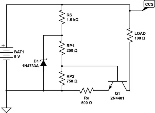

I'm looking at some old chemistry education literature where a constant current source was proposed (J. Chem. Ed. 1969, 46(9) p613, link). I am trying to better understand the circuit and could use some guidance.
schematic
Question #1 I am trying to do an KVL/KCL analysis and am getting stuck. I have the following set of equations, where i1 is the current through the battery, i3 is the current through RS and i5 is the current through RP2. (The remaining symbols are, I think, self explanatory).
eqns = {
   v - ic rl - vce - ie re == 0,
   v - i3 rs - i3 rp1 - i5 (rp - rp1) == 0,
   ie == ib + ic,
   i1 == ic + i3,
   i1 == i5 + ie,
   i3 == i5 + ib,
   \[Beta] == ic / ib
I believe I am missing one more relationship. It's possible, I think, to create one more loop which goes through the base and emitter of the transistor; however, I have to assume that Vbe is equal to 0.7 and I do not think this is correct.
Question #1 What is the recommended set of equations to analyze this circuit?
Question #2 I do not understand the role of the zener diode in this circuit. Removing it from the simulation does not appear to have an effect.

    You need to indicate not just the location of a current but also its direction. Likewise, your equations have a voltage marked simply "v" and a resistor value of "rp" that are not shown on the schematic. – Elliot Alderson Oct 19 '18 at 19:59
    The Zener is indeed useless, because VBat (rp1 + rp2)/(rp1 + rp2+ rs) = 3.6 Volts and the 1N4733A is a 5.1 Volts zener diode. – andre314 Oct 19 '18 at 20:24
  • If the voltage of the zener were below 3.6 Volts, the zener would be usefull : it would make the generated current independent of Vbat. (of Conversely if Vbat were largely more than 9 Volts, the current would become independent of Vbat. Maybe the zener is a protection against overcurrent if Vbat is much larger than 9 Volts) ) – andre314 Oct 19 '18 at 22:34
  • @ElliotAlderson Thank you for the comment; rp1/rp2 are actually part of a 1K potentiometer and I was using two different schematics (rp1 + rp2 = rp). – bobthechemist Oct 19 '18 at 23:08
  • @andre Thanks for that clarification (this is my first exposure to zener diodes and their use). In the original design, the voltage source is 25 V, so I understand why it was necessary. – bobthechemist Oct 19 '18 at 23:09
  • A TL431 current source is a simple inexpensive alternate to play with as well. https://electronics.stackexchange.com/questions/107699/tl431-constant-current-source – sstobbe Oct 20 '18 at 00:40
  • Here is the way to think a zener diode : If the voltage applied to the zener is above the threshold (5.1V), then the zener sinks so much current that the voltage drop to 5.1V (due to the external circuitery), otherwise, the zener is a open-circuit (otherwise it is burned, but in that case it is not called a zener anymore) – andre314 Oct 20 '18 at 11:25
  • It's a kind of voltage overflow pipe. So if one wants to know if the overflow pipe is active, he sees what would be the voltage without the pipe and sees if it is above the threshold. – andre314 Oct 20 '18 at 11:38
Quick analysis of this circuit
First, one must do some assumptions which stems from the art of electronic engineering.
One "verify" afterward that there no contradiction between the results and the assumptions.
These assumptions are :
  • The current in the base of the transistor is so low that the voltage at the point common between rp1 and rp2 is the voltage without load.
  • Vbe = 0.7 Volts
  • Iemitter = Icollector
Then :
  • Vbase = VBat ( rp1 + rp2)/(rp1 + rp2+ rs) = 3.6 2.7 Volts (the Zener has no effect, see my comment)
  • Vemitter = 3.6 2.7 - 0.7 = 2.9 2.0 Volts
  • Iemitter = 2.9 2.0/Re = 5.8 4 mA
  • Icollector = 5.8 4 mA
Let's see if there are no contradiction with the initial assumptions :
  • Ibase = ICollector/Beta =
    Icollector /(Something more than 40 according to the datasheet of the transistor)
    < 0.145 0.100 mA
    Ibase comes from some equivalent resistor which is less than 750 Ohms. This implies that the voltage drop is no more than 750 Omhs * 0.145 0.100 mA = 0.108 0.075 Volts
    0.108 0.075 Volts can be considered as negligible compared with 0.7 Volts.
  • Concerning Vbe. This voltage is the voltage that would develop a diode. This voltage is 0.12 Log[10,Idiode / 10^-10] = 0.7 Volts. Note that this value is very insensitive to Idiode because of the Log
  • Iemitter = Icollector is true if Vce > 1 Volt (ie the transistor works in is active region). Here we have Vce = VBatt - 100 5.8 4 mA - 2.9 2.0 = 5.5 6.6 Volts
Solution of the problem with the Wolfram Language (Mathematica)
rp1=250;
rp2=750;
rs=1500;
rl=100;
VBat=9;
re=500;
beta=40;
eqns = {
   VBat - ic rl - vce - ie re == 0 ,
   VBat - i3 rs - i3 rp1 - i5 rp2 == 0,
   ie == ib + ic,
   i1 == ic + i3,
  (* i1 == i5 + ie, redundant with the line just above *)
   i3 == i5 + ib,
   beta == ic / ib,
   i5 rp2 == ie re + 0.7 (* new *)
res00=Solve[eqns,{ic,vce,ie,i3,i5,i1,ib}][[1]];
res00  //Column
solution with a more refined model of the jonction base-emitter (Vbe~0.7Volts)
eqns01 = {
   ie == ib + ic,
   i1 == ic + i3,
   i3 == i5 + ib,
   beta == ic / ib,
   i5 rp2 == ie re + 0.12 Log[10,ib / 10^-10] (* a more refined model  *)
res01=FindRoot[Evaluate @ eqns01,Evaluate[List @@@ res00]]
res01 //Column
